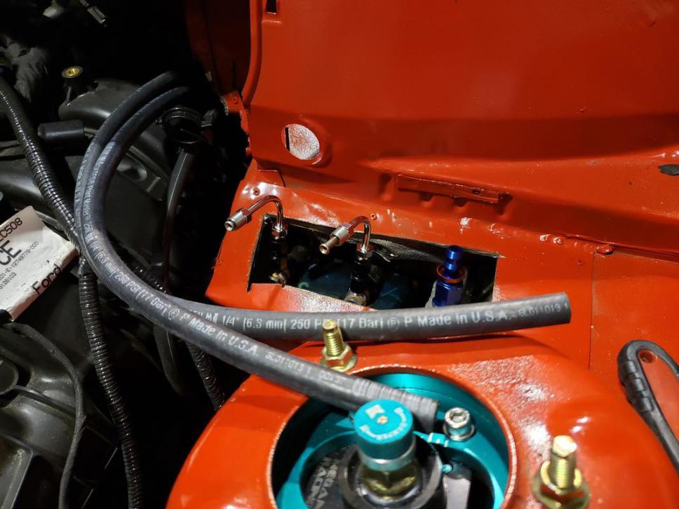

              working on the pedal box i make a cut in the firewall to get access to the cylinders. when everything is fitted up good I will make a panel with holes for the cylinders lines and rivet it over that hole. ive got the banjo fittings and all that tighted up and bolted the pedal box up for good hopefully.

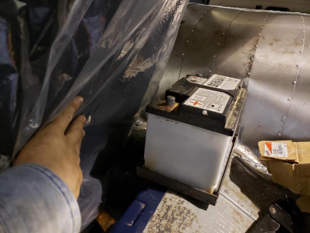

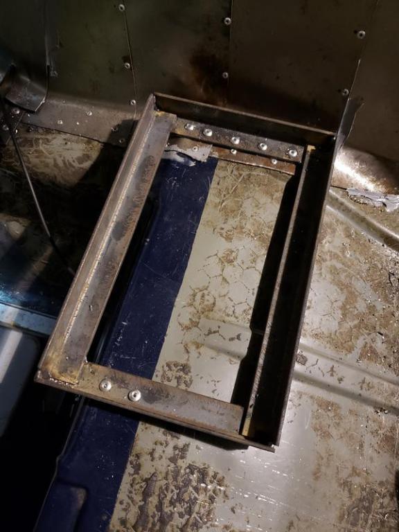

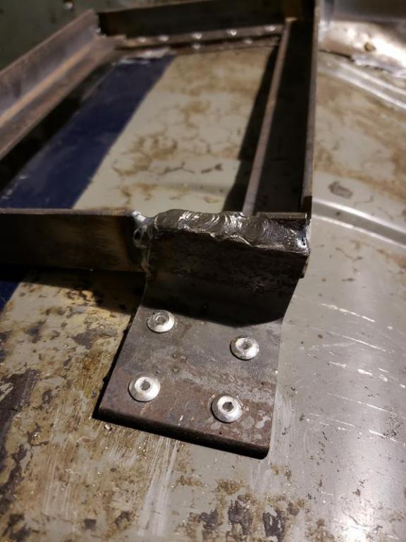

              made a battery tray and started mounting it up
              because of the curvature of the back seat area I brace this corner up
              it fits in there real good
              and will have good clearance with the seat
              I would have preferred to offset it to the passenger side of the car but its pretty central as it is right now so no worries

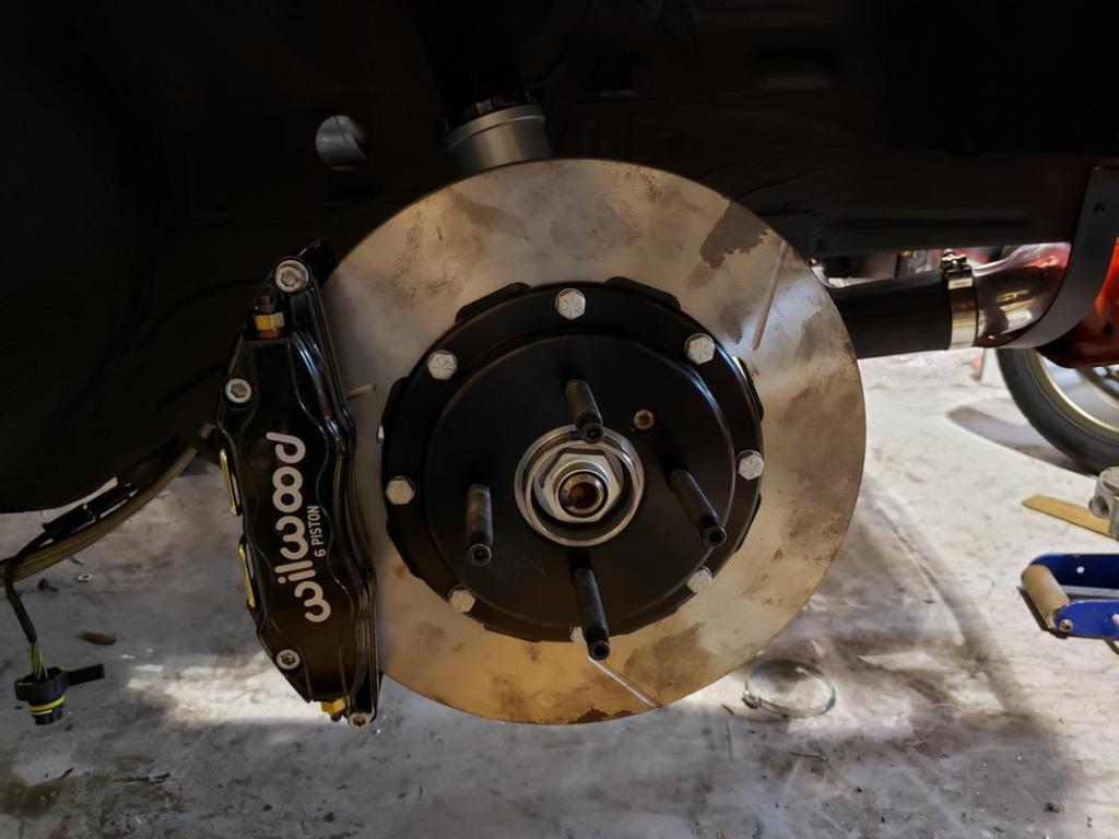

                front studs and rotors and calipers are mounted up. the front wheels wont fit, the calipers get in the way but that is fine because wheel spacers will fix that issue and the wheels where pretty deep into the fender anyways so spacers will be nice to have them closer to the edge of the fender.

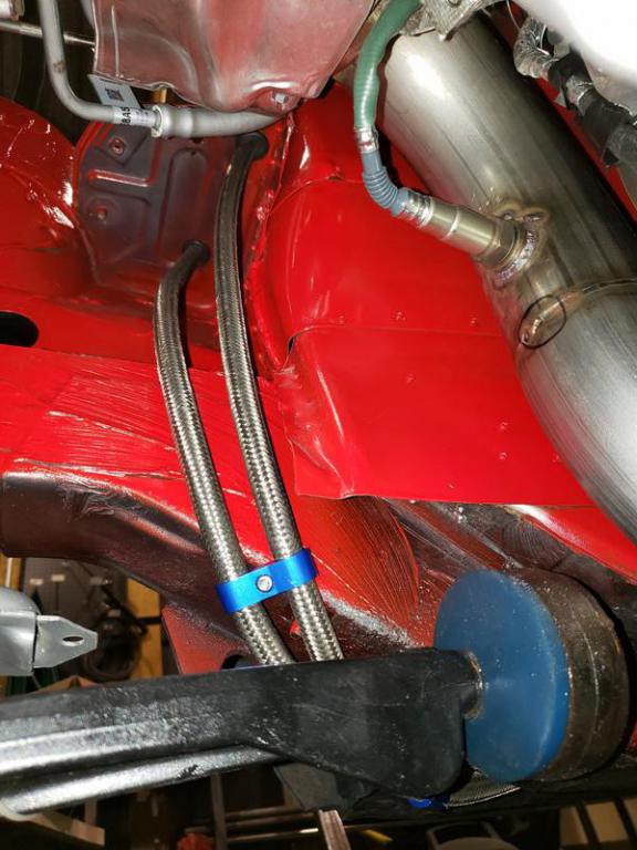

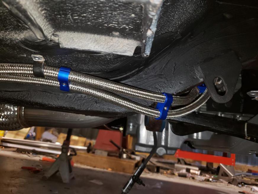

                  buttoning down the fuel lines

                      Thanks! little bit of challenge routing them to keep away from the exhaust but then crossover into the inside. hopefully they don't interfere with the control arm.

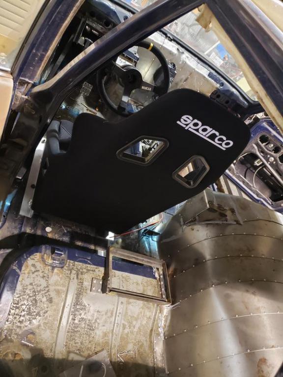

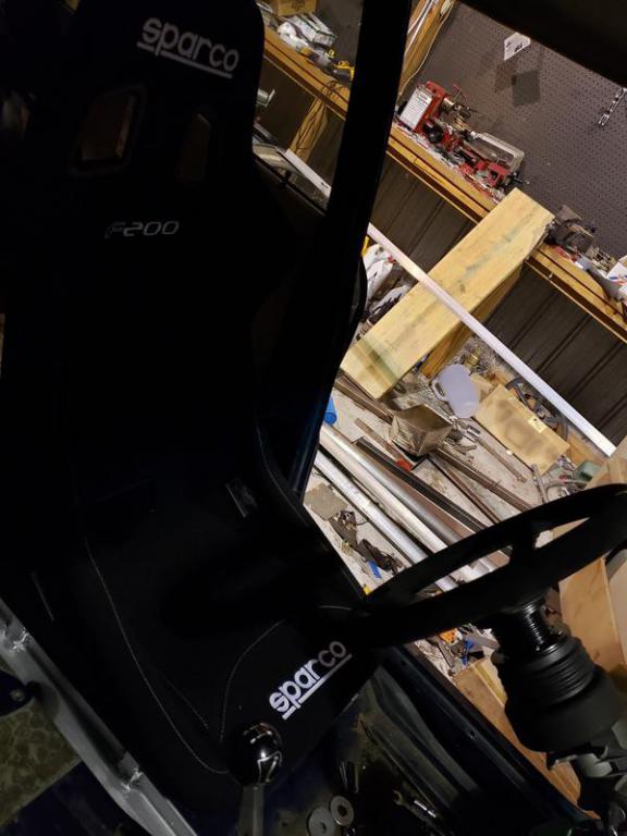

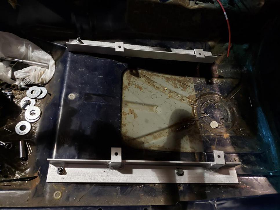

                        made mounting brackets for the seat

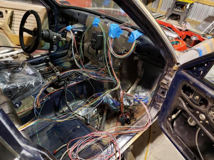

                          #192
                          so I had a stupid leak emerge that was my fault from when I was adjusting those 90deg. bends from the masters and a couple other leaks too, I done brake work before but I needed to crank the fittings down some more which surprised me because I usually have a tendency to over torque rather than under. so I had to take apart the panel and the resiviors to fix that leak but I got it sorted and bled the brakes and they feel real good.

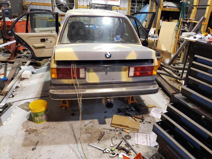

                          aside from that I moved some things around the shop and installed the lights and some of the trim on the car. then I layed out the wiring harness in preparation for getting that all sorted
