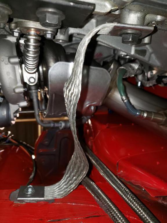

        engine ground strap
        Click image for larger version  Name:	20191019-014447.jpg Views:	0 Size:	59.7 KB ID:	9879172

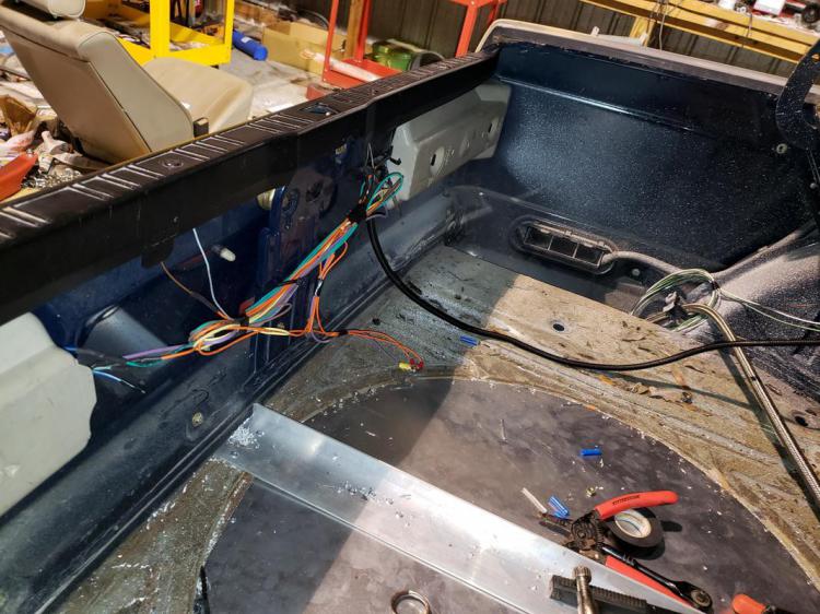

        cleaned up the rear section and it is pretty much finished
        Click image for larger version  Name:	20191016-005908.jpg Views:	0 Size:	81.9 KB ID:	9879173

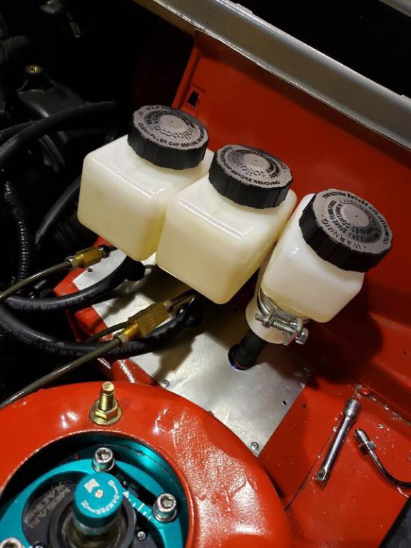

        been having brake troubles, some leakage and some of that was me overlooking that the brake lines that came with the BBK are 3an one side and 4an the other which I find kinda odd. so I had 3an to 3/16 inverted flare adapters screwed into a 4an line which actually worked for the most part but one or two leaked and then one I stripped the threads not surprisingly when I cranked it down. now I have new 3an to 3an lines on all four corners and I think ive sorted out the brakes, hopefully. no leaks so far from what I can tell.
        Click image for larger version  Name:	20191019-001819.jpg Views:	0 Size:	58.2 KB ID:	9879174

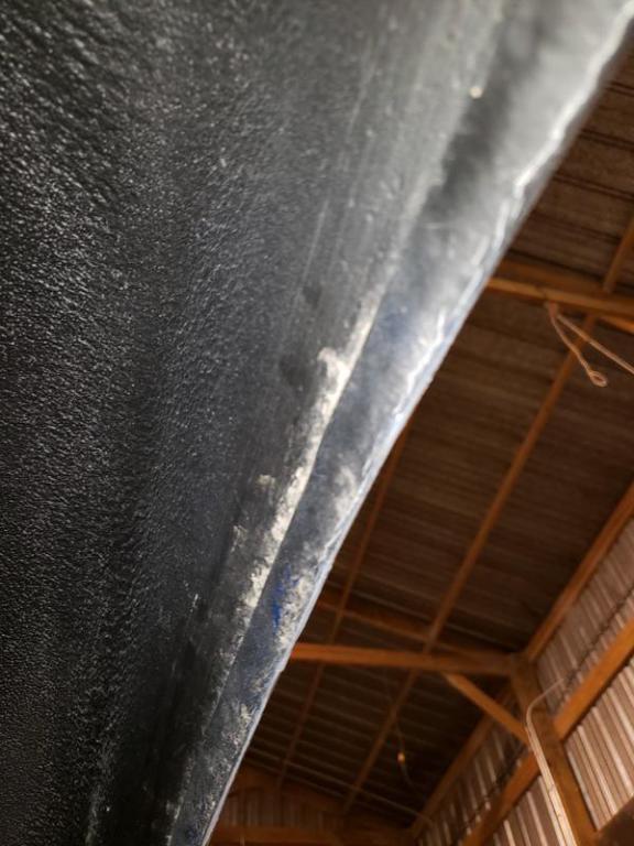

        rolled the rear fenders which wasn't hard at all. cracked the paint a good amount too, no worries. maybe that's why it was easy is because I just sent it no worries for the paint lol. fronts i will do at a later point when i get the chance to torque the front wheel bearings.
        Click image for larger version  Name:	20191019-014733.jpg Views:	0 Size:	61.0 KB ID:	9879176
