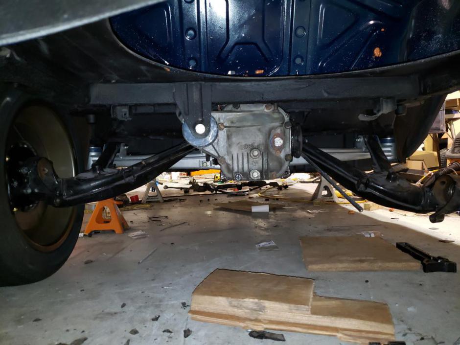

      pulled the rear subframe and bolted up the driveshaft and trailing arms and then reinstalled it.
      Click image for larger version  Name:	20191002-011237.jpg Views:	0 Size:	81.3 KB ID:	9875070
      Click image for larger version  Name:	20191002-011408.jpg Views:	0 Size:	77.2 KB ID:	9875071

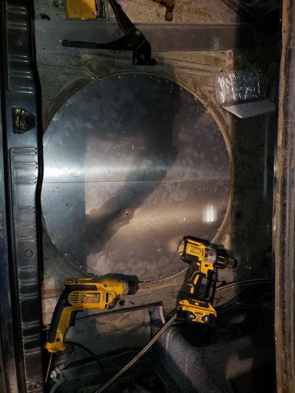

                            I cut out some really thin aluminum sheet for the wheel well
                            this angle aluminum crossmember will prevent it from sagging and flexing a ton and will provide me a place to have my final exhaust hanger mount too
                            rivet from the bottom
                            finished result

                              #164
                              For folks that see your wheel well cover I'd strongly suggest reusing the original steel wheel well and making some filet cuts/flanges to allow it to fit the hole. Works well, and is a lot stronger than AL. Only downside is that you may need a bit of seam sealer to finish the filet gaps.
