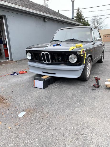

        Really been working on my 2002tii for the past week. Removed most of the floors, part of the rear quarter and driver side door sill. Everything is welded back in so i can focus on the vert again.
        I'm starting to lose hope in the double din setup though, I have everything trimmed down but the HVAC doesn't fit to my satisfaction with a LHD car. RHD this would work ok, so if i don't move forward with it all you RHD guys hit me up for a double din application lol.

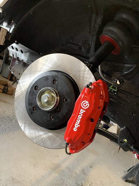

                5 lug front is done, this allows a 325x25 rotor.
                • IRP conversion kit (took forever to get)
                • E38 brembo calipers, fully rebuilt
                • going with chasebays soft line kit
                spindle tapped to m16x1.5 LHT
                Click image for larger version  Name:	49941238278_75ae9aa704.jpg Views:	0 Size:	38.0 KB ID:	9928308
