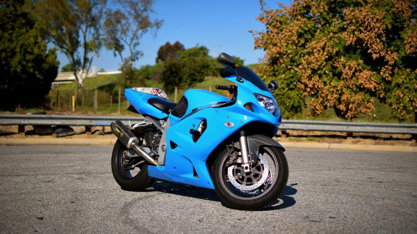

                                Here is my dirty girl, I ride her hard and put her away wet every time :) Click image for larger version
