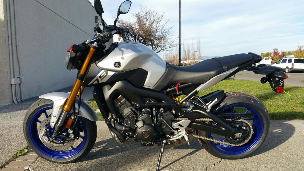

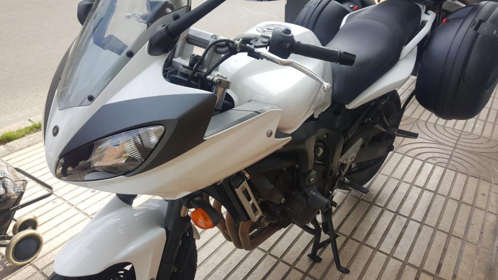

          • SelinaS19
            • Jul 2019
            • 7
            #1325
            Here's a photo of my 2010 Yamaha FZ6 S2 and 2015 Yamaha FZ 09. I can say I'm a Yammie girl.;D
            • TeXJ
              • 1914
              #1326
              if I were to get another bike, I really like the fz09/7
