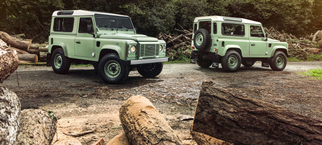

      Originally posted by LateFan
      Nice - I like the pale green one with steelies.
      I like these pickups
      [ATTACH]92855[/ATTACH]
      The new Heritage model? Me too. :) I'd love to have one of those pickups as well. Someday. :)

          No one seems to be in any hurry here...
