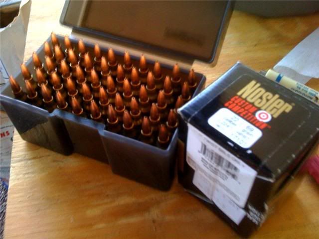

              back many pages ago, we touched on the topic of reloading. I do some hand reloading on the cheap and was working on some rounds today that I had dialed in the week before. I do not have pictures of the brass prep because this time I sent my brass out to a processor. Being that processing brass is the worst part of the reloading process.
              Anyway these are the last few steps of the process. Thought I would share.
              I was reloading the following.
              LC brass
              H335
              CCI 400
              Nosler custom competition 69 grain
              here, I have sorted out the brass, placed primer in the cartridge and measuring out the powder. This was 23.5 grains of H335.
              once I got 50 of them measured and poured into the case I go to my make shift bench and ready for the single stage press. LEE die is set to 2.255 for OAL.
              placing the Nosler bullet on top of the casing and a quick pull of the handle
              the finished product of 50 rounds. Its a bit slow doing it this simple but you get about as perfect as one can get. Much better QC this way over a progressive press.
              the Results: 5 rounds at 100 yards. With out the one flier, the grouping would have been a .473 MOA well into the sub MOA range.
              Ending.... Awesome day at the range!
