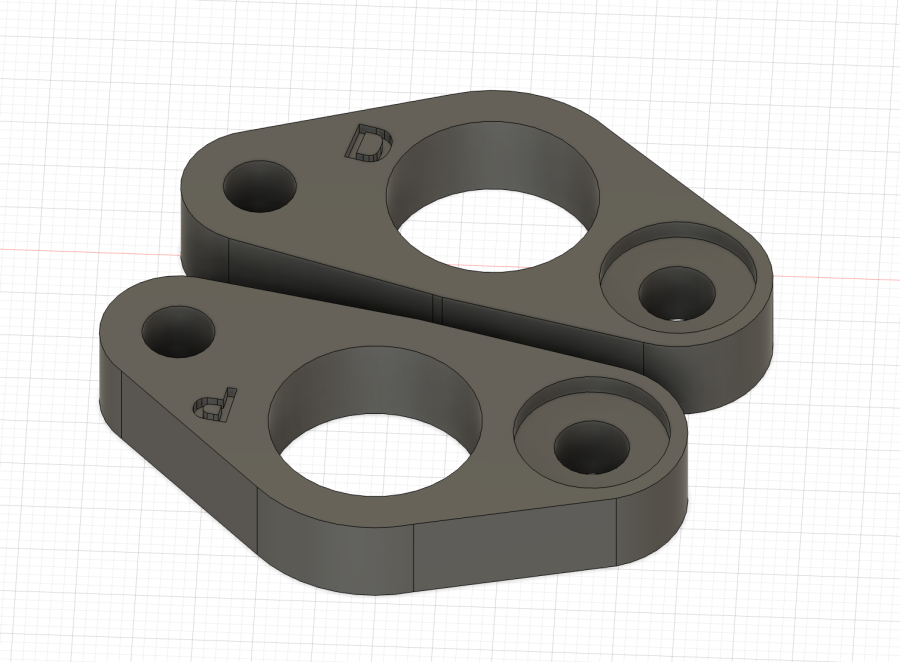

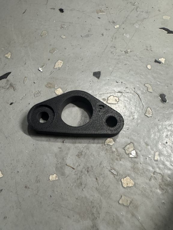

            I am onboard the MK60 train now. Not because I track the car but because I want more room for an airbox and I'm determined to get cruise working on the N52 swap(even if I end up having to switch half of the Z4 parts into the car). I have the Z4 MK60e5 which will work with e30 rings and has a much smaller steering angle sensor.
            So far I've managed to get the Steering angle sensor coded to match the VIN on my MSV70 and coded the MK60 for options I want. If anyone goes down this route I made a DSC_85.SSD VO file you can have for NCSExpert, you will only need to change the VIN.
            Front E46 sensors fit on the E30 with a 3d printed adapter, I haven't tested the rear yet but it looks like the e46 sensors will require modification in a addition to a printed adapter. Front is buttoned up. Hoping posting here will motivate me to get started on making new brake lines and running new sensor wires. I went with NICOP when I changed the lines before but they are already starting to turn green so I will probably use stainless this time.

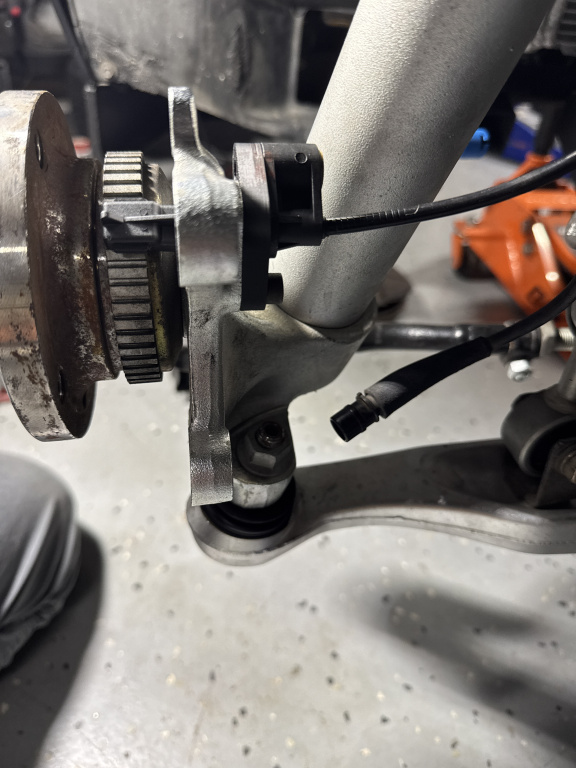

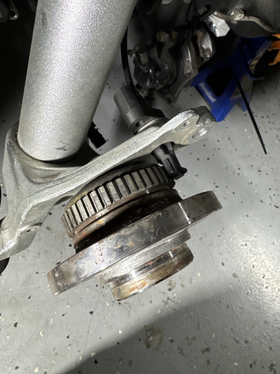

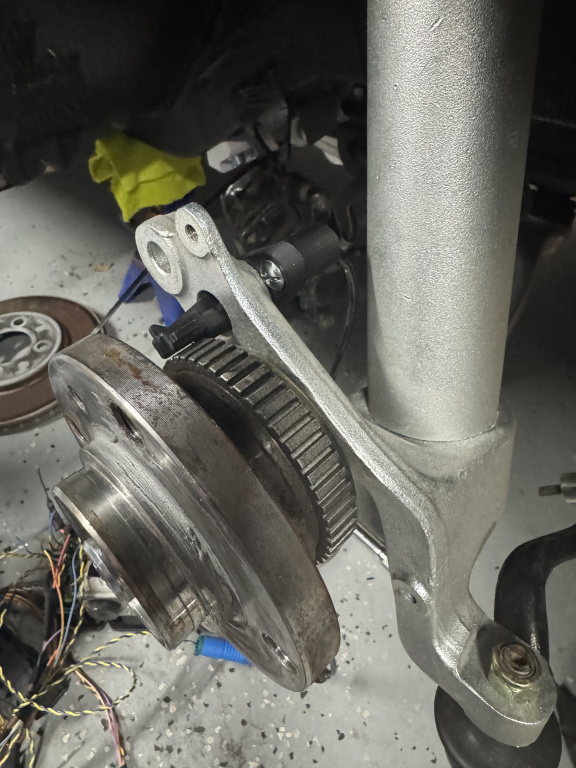

              Front adapters fitted installed to test.
              Click image for larger version  Name:	IMG_2527.jpg Views:	0 Size:	181.6 KB ID:	10151362 Click image for larger version  Name:	IMG_2530.jpg Views:	0 Size:	148.1 KB ID:	10151366
              Click image for larger version  Name:	IMG_2488.jpg Views:	0 Size:	190.9 KB ID:	10151363 Click image for larger version  Name:	IMG_2489.jpg Views:	0 Size:	150.2 KB ID:	10151364
              Good to go! Now onto the back.
              Click image for larger version  Name:	IMG_2528.jpg Views:	0 Size:	306.9 KB ID:	10151365

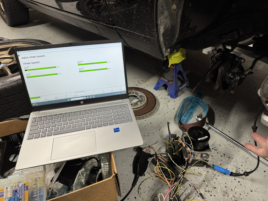

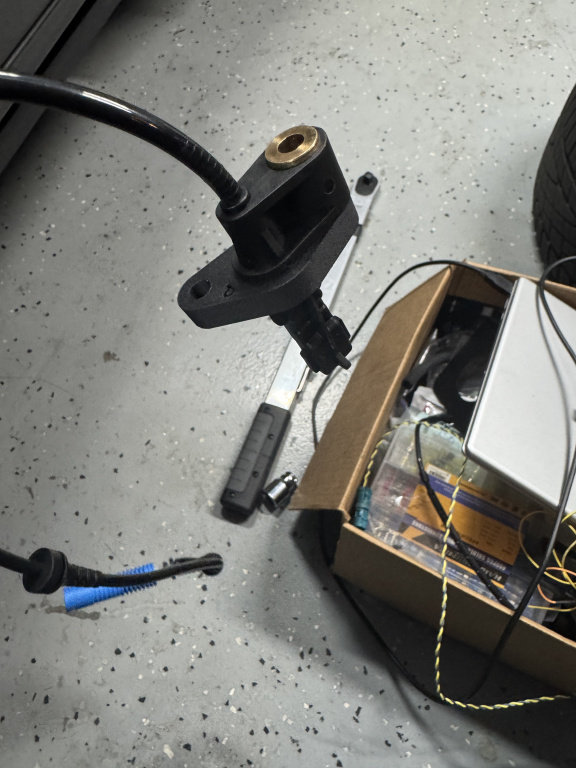

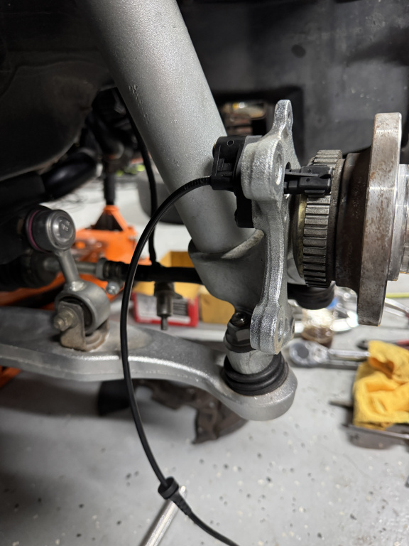

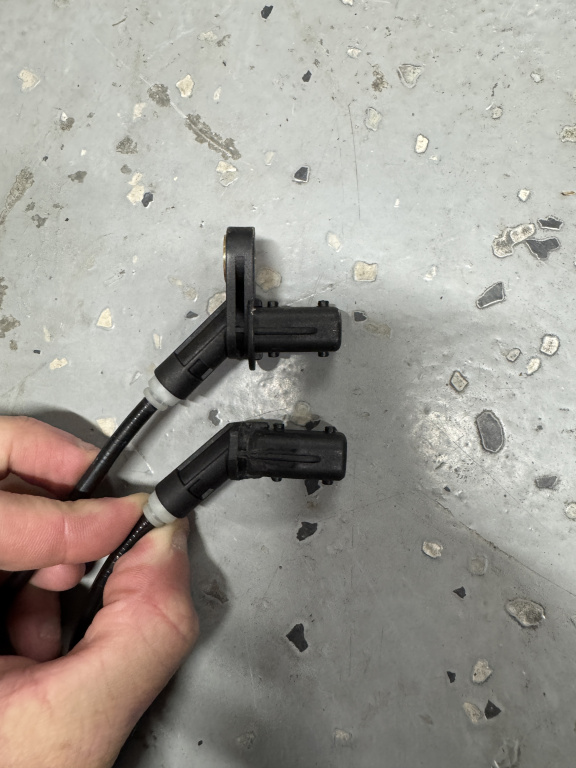

                Rear was a lot more work. One cut for each sensor and 10 minutes with a carbide bit on the dremel. I didn't pull the rear hubs to get pics but INPA is reading as it should.
                New sensors are too shallow to work, I did test hoping but no good.
                Click image for larger version  Name:	IMG_2537.jpg Views:	0 Size:	151.7 KB ID:	10151501
                A few minutes on each sensor with the dremel and cut the tab off with my reciprocating hand saw. Had to remove the entire bottom "lip" to get the depth right.
                Click image for larger version  Name:	IMG_2536.jpg Views:	0 Size:	138.8 KB ID:	10151499
                Click image for larger version  Name:	IMG_2535.jpg Views:	0 Size:	154.5 KB ID:	10151500

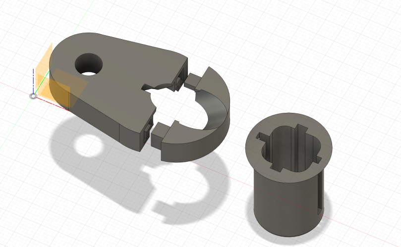

                Much better! I added a sleeve to the bottom because there wasn't much sensor left to clamp. All 3 pieces of print are bonded together and to the sensor.
                Click image for larger version  Name:	IMG_2534.jpg Views:	0 Size:	171.1 KB ID:	10151498
                Click image for larger version  Name:	Screenshot 2025-11-24 at 12.36.58 PM.png Views:	0 Size:	266.0 KB ID:	10151502
