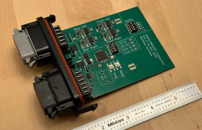

    As a public service, there's now a signal converter that will let you use your stock e30 sensors and rings with the E5. It's pretty slick...
    Next batch is on the way, expected to ship late October, but available to backorder now! Unlocks modern Mk60-family ABS controllers on older vehicles with "passive" VR wheel speed sensors. No need to modify your hubs/knuckles/axles to upgrade your braking! Compatible ABS modules: MK60 from BMW E46 (RWD, 2003+) and Mini

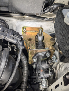

        I've been having issues with my FL brake dragging when it gets hot, at first I thought it was lack of slack in my linkage and the MC wasn't venting fluid, but yesterday it was happening consistently almost exactly 10 minutes into each session.
        I *think* it was caused by one of the pads being too tight between the upper and lower bridges, like the steel backer was expanding with heat and jamming the pad. It was very difficult to pull out.

                      also, the Wiwood rep told me that the pad steel backers are stamped and can be off the spec.
                      Our shape is supposed to be 4.75" and I measured a few that were a few hundredths more. Filing the ends smooth and to spec made them slide in and back & forth like 'butta.
