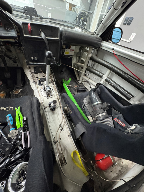

                                #75
                                The current state. Ran a prop valve where I can reach it while strapped in. Put the ABS in the cockpit under the dash, pulled all the wiring off the front of the car that was used for ABS and re-routed all of it into a 12 pin connector so the Happy Cactus converter can plug directly into the chassis now. It's a mess but it's coming together. The electrical is done, everything is happy in INPA. I did notice that I have a 2008 yaw sensor with the "B" plug interface and it actually required a different pinout than what's on the happy cactus garage wiring diagram. Im getting all of this together and I'll make a separate post at some point to share my own experiences, but so far, so good. i'll also share the 3d printed mounts which helped out a lot.
