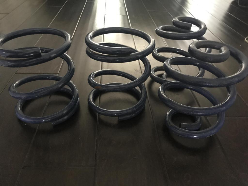

                            • robrez
                              • Jul 2008
                              • 3376
                              #59
                              Here’s a pic of mine. Also bought cheap on eBay and sold as Dinan J-Stock. Looks familiar?
                              Originally posted by ForcedFirebird
                              Got some used the Dinan super cheap from eBay, so threw them in a car to try out for a few races, and would agree they are very similar to the H&R/IE just based on driving experience.
                              January 2012 COTM
