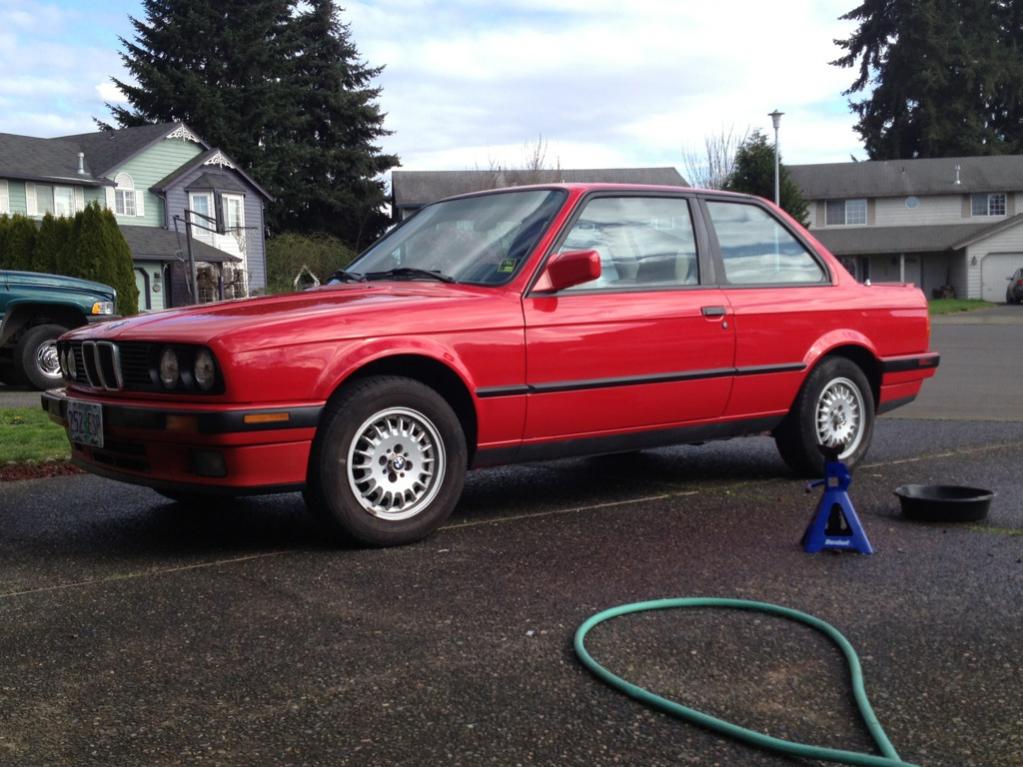

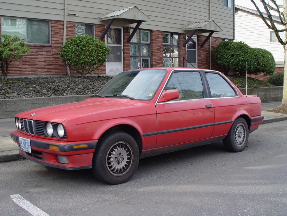

    So you guys... Um it's official. Nika is done!! Yay! One if the best days of my life. Runs nd drives smooth. Took her out to 205 today. Ran like she should!
    When I got her!
    And now:)!
