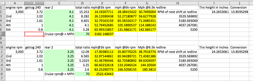

                                Gearing... 4.10 vs 3.25 205/50/16 tire
                                -Christian
