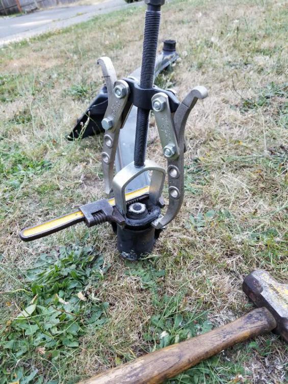

      Nice vert Brad! I got that other trailing arm off pretty easy with a Drexel.
      Question for all... Rear subframe bushings. Before I finish making a tool to pull out the steel sleeve with the bushing in it, am I supposed to? People burn the bushing out but never show pulling the sleeve. And pictures of new bushings are too small to tell if that sleeve is part of the bushing.

        I think gerta has a subframe tool he loans/rents out if you need it, it should pull the bushing and the sleeve at once.
        if you burn the bushing out i believe you can cut the sleeve and chisel it out.

          #36724
          Thanks for the info. Ya, I'd prefer to pull the subframe bushings instead of burning. A couple more cuts on some steel and I'll have a puller. Maybe burn the trailing arm ones though.

                  #36728
                  I burned mine out. It was a lot easier than I was expecting. came right out.

                    #36729
                    What I didn't realize was there is a thin rubber coating on the outside of the steel sleeve. Oh well, they came out pretty easy.

                      #36730
                      Made easy work of that!
