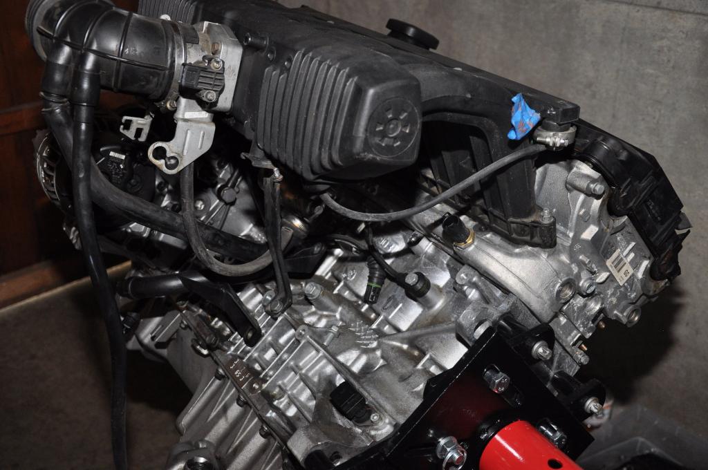

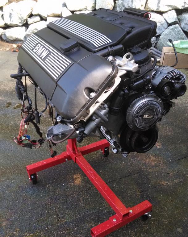

    Anyway, I've been running the same M54 since the end of 2008 and it's been a great success. I've changed configuration on dozens of things, made lots of trips to the dyno and learned everything I would need for the second M54 swap.
    So, I picked-up a 85k mile motor out of a wrecked cream-puff e39 this weekend. It'll be easier to start with this motor than to pull my existing one and have the car down all year.
    The plan includes:
    -ArcAsylum subframe and notched oil pan. The e34 pan has always bugged me hanging out front.
    -Megasquirt wiring from the git-go. I've got a mashup of M50, M54 and "other" wiring harnesses
    -M50 intake manifold. The head will be port matched to the larger intake diameter.
    -ArcAsylum headers??
    Dyno data from a similar setup demonstrates 250whp.

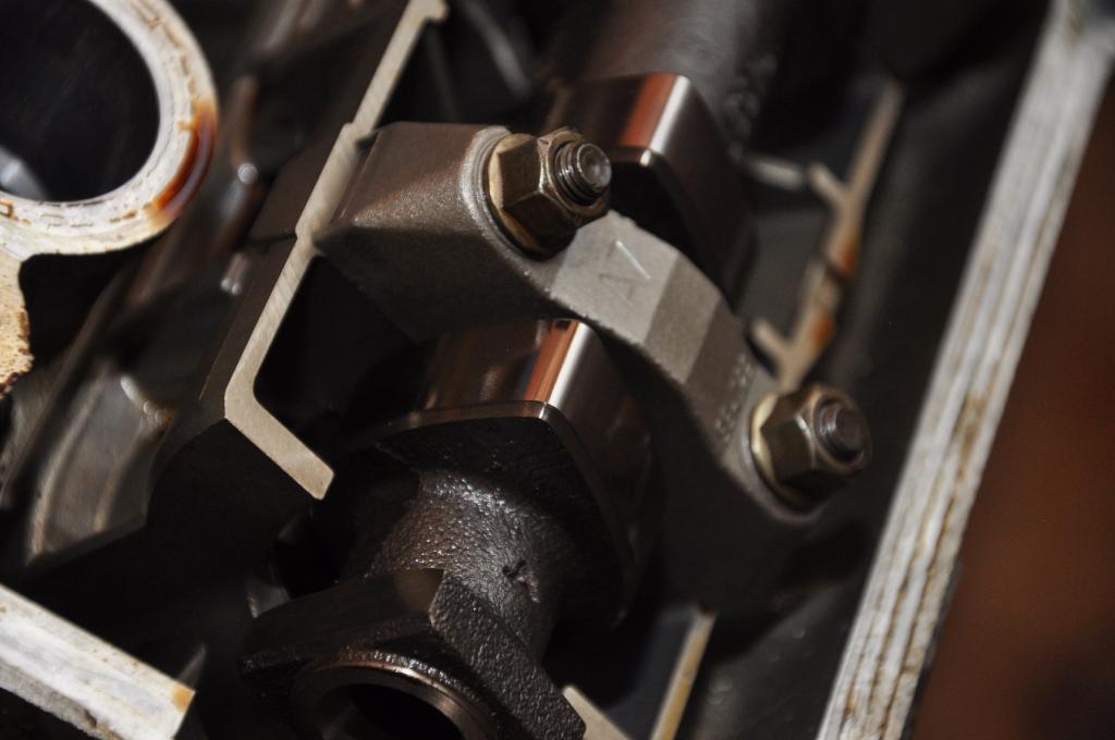

            Off to a good start..
            Removed my valve cover and it's as clean as I could hope. The cam lobes are gorgeous. This motor has had a good life!

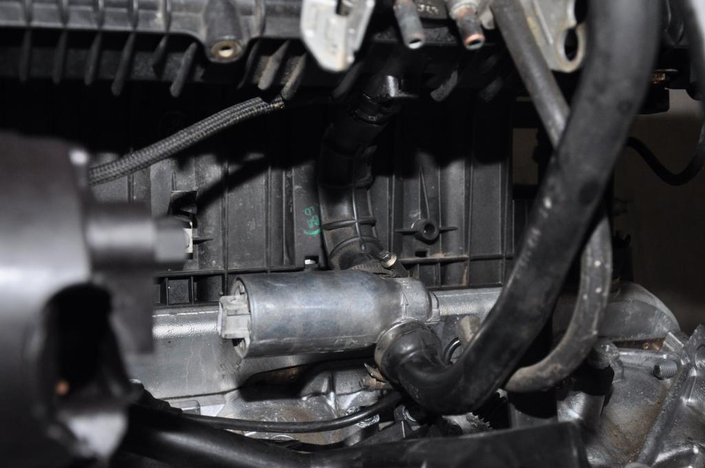

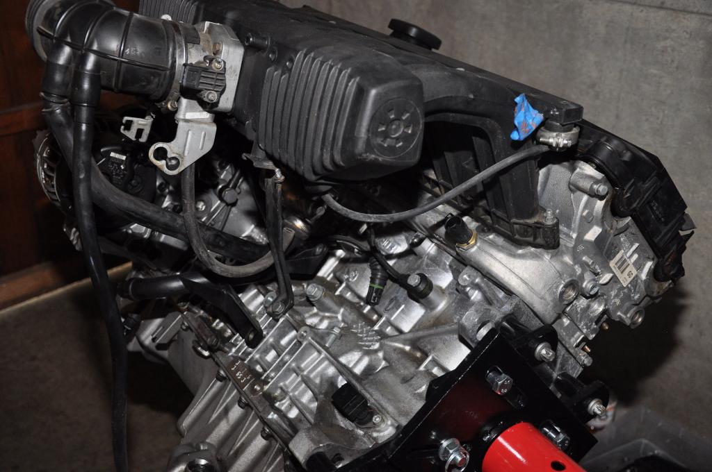

                Anyway, I did go and pull a complete M50 intake the other weekend. Came with absolutely everything. After pulling some of the extra studs on the head it bolted-on beautifully.
                The support strut to the block was a quick and easy mod.
                The current task is that I need to locate and mount the ICV. The m50 has it attached to the block at the wiring support bracket. The M54 has it attached to the bottom of the manifold. I would prefer to have it on the bottom of the manifold so that it will lift off as one assembly, so I need to resolve that.
                After that, I'll pull the head and match the ports. My latest intel is that the motor had closer to 67k miles, so the head won't need any work, but I'd still like to match the valve guides to the port wall and other minor porting.

                        My current status is that I'm fabricating the the ICV bracket. After that, the head will come off.
