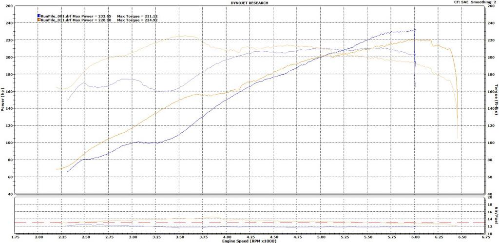

            Here's the plot. I'll let everyone digest this and then post the old motor superimposed with this plot.
            Keep in mind, intake cam static timing is off by 6 degrees (more retarded), VANOS seals are weak so the cams aren't tracking that great, ignition timing is probably Ok but not optimized. Fuel seems fine.
            Of course, the 6000 rpm rev limit ghost in the software.
            Still 232 at 6000 isn't a bad start...

              if anything, a bit of mechanical retard is helping your top end power - assuming it's the intake cam.

                Giving up DISA and /or the new exhaust seems to have cost a lot of torque below 4000rpm?
                Looking back at your earlier dynos this change definitely takes you over to the Dark Side! - Top end high revving power gained at the expense of torque below 4k rpm.
                It would be interesting to see this dyno compared to a stock M50B25, not for absolute figures, but for how the power is delivered. I suspect you've gone a long way to achieving your objective of performance like the M50B25 with a rising crescendo as it comes on song over 4000rpm?

                  Those headers/close collector are KILLING your low end power and you're probably gaining nothing up top for it.

                    Compared to the original motor with ZHP cams and DISA intake....

                      At 3250rpm you are down by -35HP & -60 Ft lbs - is there something amiss to affect things this badly?
                      Do you think DISA is giving you the huge 2500-4000rpm gains in the old engine?
                      This was always an experiment, so what are your current thoughts?

                        not 100% tuned yet, but them headers and collector......probably never going to provide as broad a power band

                          I expected it to be down a little where DISA is most effective because, seriously, DISA kicks-ass where it's effective. The stock M54 is really great in that band. The stock M54 is a good motor, period.
                          That said, my tuning and configuration isn't as strong as it should be. I'll be going back to stock OBD2 headers primarily because they're more civil, but they'll probably be better than my current headers. That will help.
                          I'll re-time the cams and replace the VANOS seals, which have been very bad at maintaining cam position.
                          It'll be better.
