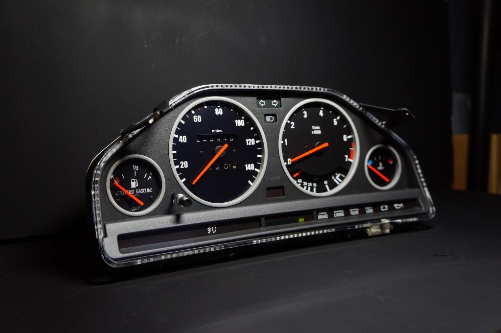

                                Having the battery disconnected so much recently killed my cluster. No tach, no temp, etc. It's been at Bavarian Restoration where Greg r/r the SI board plus a few enhancements.
                                I'll try to make a dyno visit in January.
