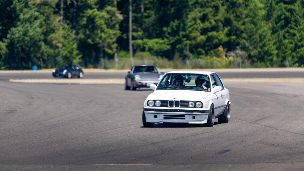

            First HPDE a few weeks ago. Engine was great; pulls hard where it needs to and keeps up with plenty of "M" badges. I had a blast and have a long way to grow my abilities to match the car.

                Pacific. At the Ridge this weekend :)

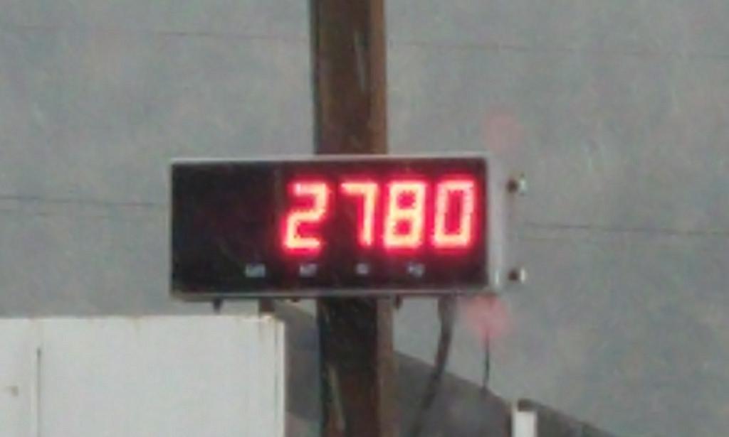

                  Crossed the scale at 2780.
                  -205lb driver and my winter weathertech heavy floor mats.
                  -3/4 tank of gas.
                  That puts me at around 2560+/-. Not bad...
                  Stock curb weight is 2844.
                  M54, no a/c. M50 intake.
                  No tar, full interior, sunroof delete. No radio/speakers. Single 2.5" exhaust. w/o cat.

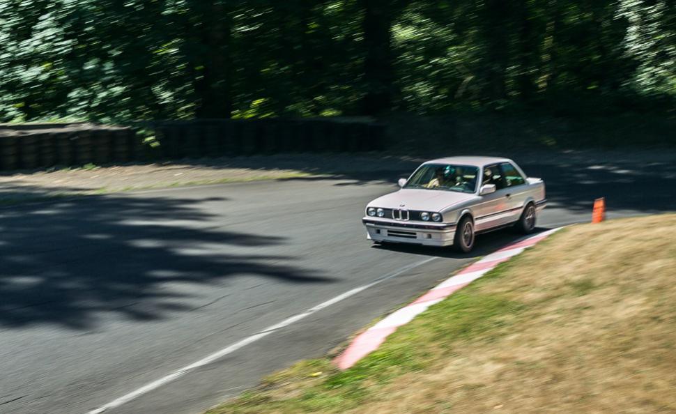

                        Car's been at the track all summer. I was dueling with an S54 Z4 for about 5 laps a few weeks ago. He pulled on the straight but I caught him in the back, it's been a lot of fun!
                        I'll install a metal M56 valve cover after the Ridge in a few weeks.
                        • 2mAn
                          SeƱior Mod
                          • 21083
                          #252
                          we need action shots!

                              It is a different engine. It used to have great torque at low revs and fall on it's face after 5500, now it's weaker on the torque but doesn't fall on it's face as bad. (ok, it pulls pretty hard...)
