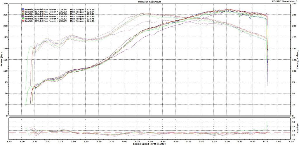

              Hit the dyno this morning. I tried some different VANOS profiles, mostly intake, and some slight timing adjustments. I found that it likes a little less intake advance below about 3000, it responded nicely to exhaust retard above about 4500, and I got a 2HP bump by advancing my timing 2 degrees across the board.

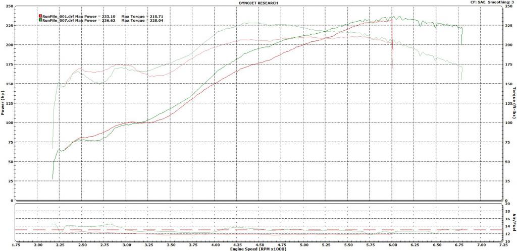

              Unfortunately, I didn't do a run where I could incorporate all of those changes into the same run. The attached shows my baseline tune with 10 degrees of exhaust retard across the board, which made it suffer on the low end. It's compared against the pull when I first installed the motor, with the oversized and obnoxiously loud headers.
              237WHP is decent considering I have OBD2 headers.
              If someone could explain why I have a peak at 2500, a drop at 2750 and another peak at 3000 that would be swell.. I did get that to flatten out by having less intake advance.
              Here's all the runs together:

                237whp is NOT bad at all! Nice

                  That is rather nice, and that 20-25ft/lb bump in the 4,000-5,000 range must be very nice. According to my tuner, that raggedness in the curve on the top end is usually the DME fighting knock/detonation. Keep going! It's looking really healthy.

                    Collector is too close to the headers, causes exhaust gas reversion. Super healthy and awesome numbers, some of the best I've seen from a stock cam M54.

                        Considering the car was rated at 225 crank hp stock, I'd say 237whp is damned impressive :up:

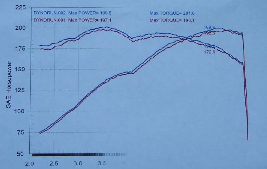

                          This is about what a stock M54 looks like. While I make way more power over 4000, I've actually lost torque and power below that. I'm down 35 ft-lbs from my previous motor where I was well over 200 torques at 3000.
                          The old motor felt more like a V-8.
                          A good header would probably restore about 15-20 torques where I need it, the OBD2 manifold isn't bad but it isn't great.

                            are you using the OBD1 intake or the Disa intake? Disa makes a big difference in low-end torque.
                            Power is about equivalent to an N52 with headers/tune (but less low end torque). I think there might be something to the comment about ignition knock at higher RPM, the graph is fairly wavy. It might even gain some power with less ignition.
