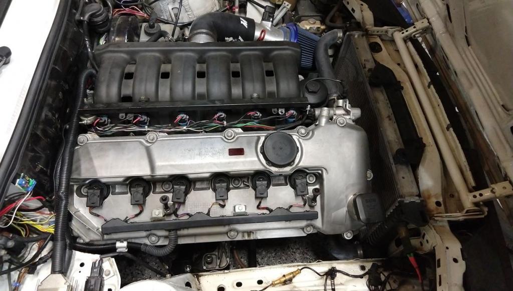

          Small update. I installed a metal M56 valve cover. The plastic M54 one can crack and leak, a new one is $379. The M56 cover will never crack and has robust oil vapor separation built-in, plus it simplifies coils to the later pencil design. (no more bolts!).
            Plug and play?

              Originally posted by robrez
              Plug and play?
              Mostly. It fits the head just same. The coils are different so the wiring harness needs to match.
              The round black cover is for the integral PCV. It used to not be serviceable, but now the membrane can be ordered from Russia and there are 3-D printed plastic caps (the tabs break when you remove it). I want mine to be be labeled "NOT OIL" in big letters.

                #262
                that looks great!
                quite a head scratcher when you look at that motor, but I like it. Just says "euro motor" to me even though its just a M54 for the most part (extreme over simplification)
                  I always find it amazing the m56 was good for something afterall!!
