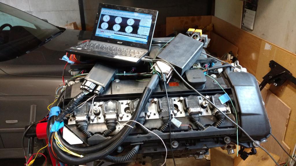

                  Motor is 99% wired. I have a few small details, like adding some pins to the C101 because it came from an older car.
                  Re-creating the entire engine harness in megasquirt is kinda time consuming. I'll need to power the engine and "run" it on the stand to test that the main relay and and all of the connections are doing what they should be. I should be able to turn it by hand and see the crank signal, etc.
                  I'm really hoping to install it in the next 3 months.
                  • hoveringuy
                    • Dec 2005
                    • 2754
                    #99
                    I'm down to final details before starting the swap. I connected the MS3 yesterday and the nice thing about it is that I can test almost all of my sensors and systems before actually installing the motor. Fuel injectors fire appropriately, the coils spark (which is a big win, because with the Toyota igniter box was kinda complicated..). Fuel pump gets power on command. The only thing I couldn't test is my crank signal because the MS3 is still configured for the VR sensor in the old motor, and this one has Hall which will require some hardware configuration.
                    I also need to clean the wiring now that everything is verified working.
                    Swap in a few weeks??
