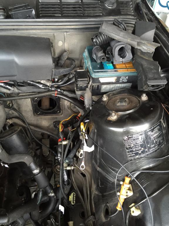

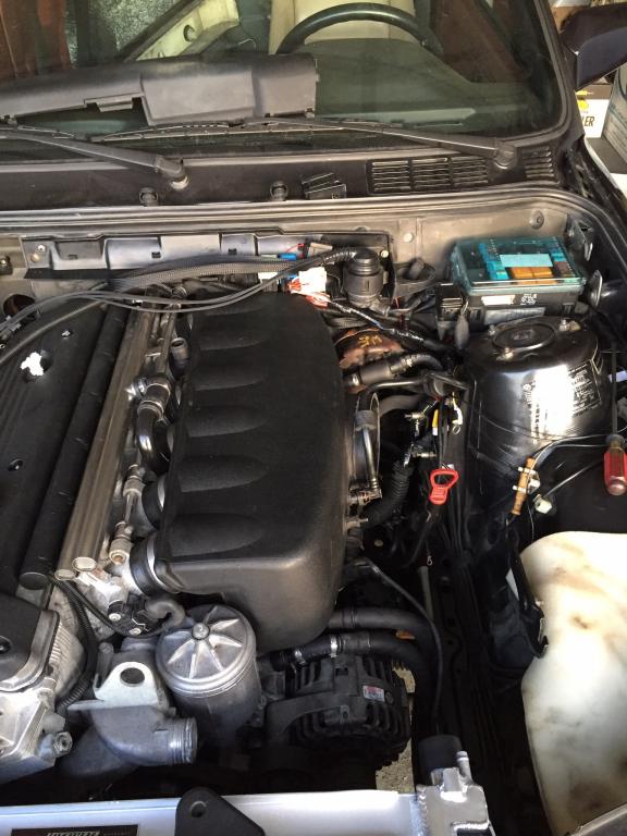

                        #131
                        Originally posted by WannaBe30
                        I'm curious to see your after removing the plastic and rubber from the wire harness
                        Here's what I did, for those using the e46m3 harness, wires and replay will fit in the e30m3 cover. I cut off all the rubber and plastic box from the harness and taped it up nice and tight.

                        • WannaBe30
                          • Feb 2013
                          • 295
                          #132
                          Nice!! Looks better than mine!
                          So there's a booster somewhere under all that?

                            • jink0619
                              • 808
                              #134
                              Sitting on the fuse box is the stuff I cut off. Still have to extend the Maf connection.
                              E30love
                              • jink0619
                                • 808
                                #135
                                Thanks man, yea it's in there, amazing how there's a booster that small huh? Lol need to have the shaft modify and paint the booster to make it purdy.
