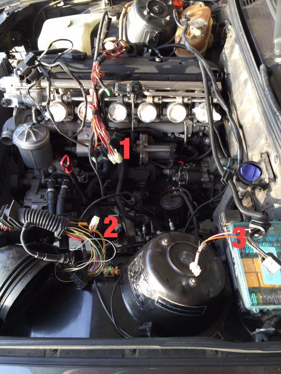

      I'm having trouble figuring out the wiring harness. I'm using the e46m3 harness so my swap ppl pls help, the 3 looms in the pic where do they go?

        did you buy an adapter
          #94
          Might sound dumb but they look backwards. That tuber weather stripping on number two I have below my master cylinder.

            I bought Andrews adapter
            The number 2 loom can be pulled over to the booster, so does it tuck inside the car or sits out?

                Some connectors will be in and some will be out. What I did was connect his adapter first so I could see where all the plugs went.
                There's only like two that will go in the car to the computer from the harness then a few more to his adapter (in the car) like the sport button throttle etc the rest don't matter. I can snap close ups of whatever you want on mine o also used e46 harness
                It's tight
                You'll prolly need to extend the plug for the maf

                  Ahh ok, Andrews adapter looks complicated as well damn I hate wiring :( if u could snap some pics would be great! pics of where the loom that the O2s plugs in and the 3 relays. Whatever pics u can take, thanks man. Text me pics 4434150870

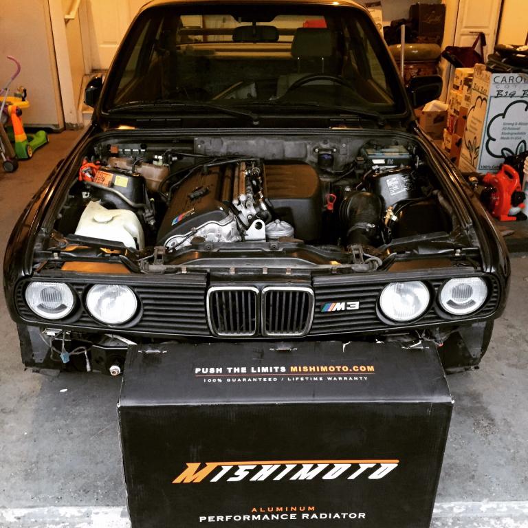

                    The harness giving me a headache so turned my attention to cooling. I got a Brandnew Mishimoto rad from a very cool person, just wanna say that there are some pretty awesome ppl in this world, guys looking out for one another such a blessing.
                    There are a few radiator options to choose from, my initial plan was to use the e46 rad, it's thick but short in length and will require custom brackets to fit. I don't have the materials for that so choose to go with a e36/e30 rad.
                    E30love
