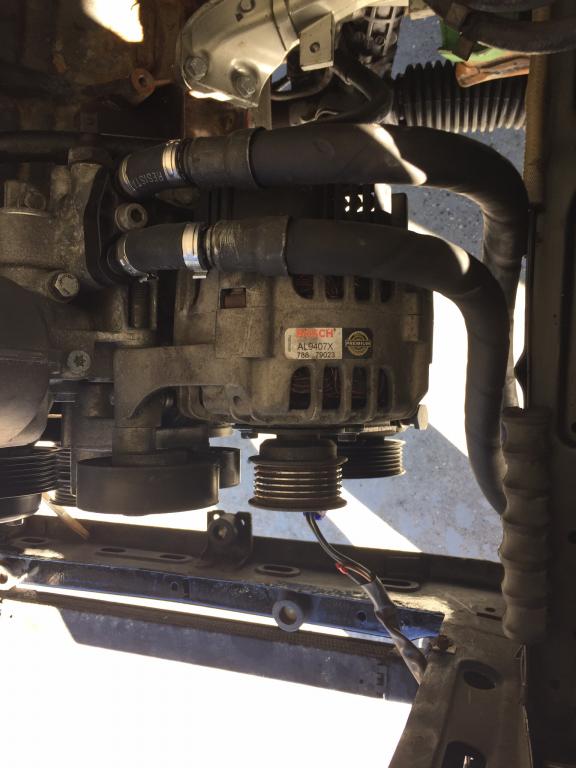

    I got the oil cooler done today, so what I did was I used the stock e30m3 lines cut the ends off and clamped on e46m3 fittings.
    This method saved me some money for other needs, looks fairly decent so I'm ok with it but really didn't have a choice anyways, I couldn't get the stock lines off cooler.

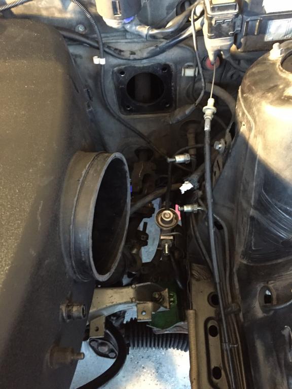

              So my booster of choice is from the 2002, I'll have to modify it alil, cut the U-joint off and weld on my stock e30 Rod with the proper length measurements. The 735i booster will also work but would need to be notched over and you'll have to modify the shaft and where it mounts to the car, too complicated for me so will go an easier route with the 2002 booster.
              As for the e46m3 FPR and giant size fuel filter, I've deceided to ditch the fuel filter and keep my stock, but as for the FPR, I mounted it just below the booster.
              *735i booster doesn't fit without serious modifications, notch over and cut booster

                    The e46 filter is enormous! I just couldn't find a location to mount it without looking ridiculous, also I didn't want to have the fuel lines at such an awkward angle. I think the stock e30 filter is enough so it should work.
