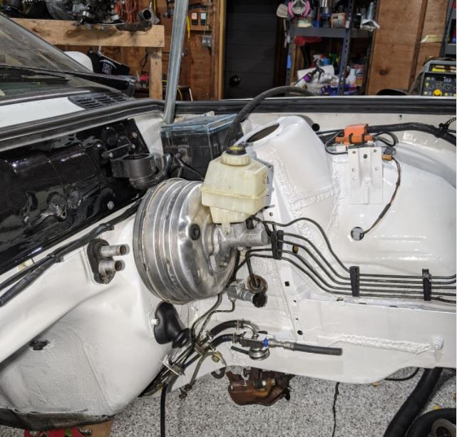

    Since the thread has been so quiet, I have one new picture. This is the E46 M3 FPR. I fabricated a bracket for it and painted the engine bay while I was at it. Also Wilwood 260-12627 proportioning valve while I was at it.

      Where's the Tesla booster? :P
      I haven't had time to even think about E30s since the i3 master cylinder came in the mail. I still think there's an "easy" solution, I just haven't found it yet.

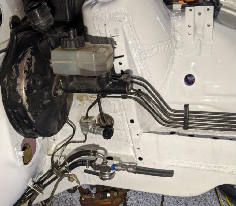

                Better? X3. I'm working my way up to Tesla.

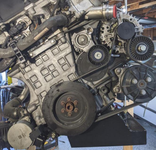

                  Small update. With no AC compressor the serpentine belt needs to be an exact fit because of the deflection angle of the tensioner. The E90 world has been doing this for a while to cope with AC compressor bearing failures, and the conventional wisdom is to use a Duralast 433K6 belt. I tried that one and it was too long, the only one that works for me is the Duralast 431K6. Effective length 43.1 inches and outside circumference 43.67".

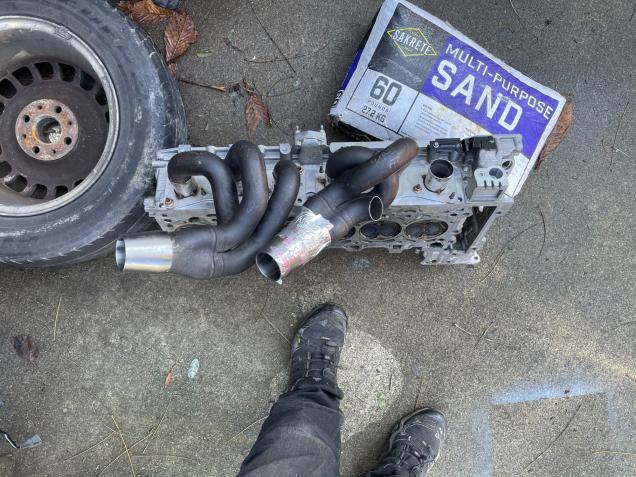

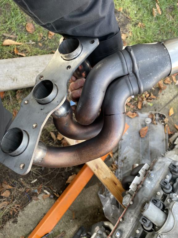

                    All of the BMW 6's have a common bore center, so adapting headers from a different engine completely is a solvable problem... but all of the M5x engines have ovalized exhaust ports, so the primary tubes are the wrong shape. The S54, however, has round exhaust ports of a very similar design to the N52, but the flanges are face-mounted (whereas the N52 has a little stub of 40mm exhaust pipe that seats into the head, and forms the "squish seal" with the cone cut into the face of the head). This is a newly cut flange mated to S54 exhaust manifolds (after cutting off the S54 flanges) by way of a short expanded section of 40mm stainless tubing:
                    With this loosely fit together, and with a 2.5">2" cone taped to the collector, the front bank fits through the engine arm thus:
                    This was very exciting for everyone nearby, as at least two pairs of these manifolds were available on ebay at the time for less than $75... I don't want to think about what it would cost to have these made. You can see the aluminum tape in the background. This stuff is absolutely incredible for fitting this tubing together. It's sticky, stiff, and you can scratch a little piece out of it to tack weld. While I waited to figure out how to tack weld stainless... I moved back to the pan. Honestly, my mig welding is completely passable for this:

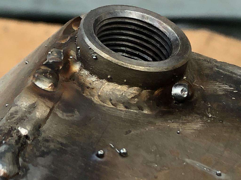

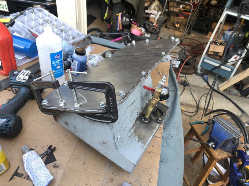

                    BUT, when subjected to a pressure test... it was absolutely hopeless. I can't stress enough how impossible it is to get rid of pinhole leaks through these little fillet welds. It was a complete nightmare. Steve had gone to extremes to get his to hold pressure overnight, and mine... it was never going to happen. I considered starting the pan over several times, before deciding I was just going to smear epoxy over the welds before painting it. If it leaks, I'll make a new one:

                      I was pretty proud of the work when I started, but as I marked all the leaks, cleaned off the soapy water, got the welder out, patched over them, re-sealed the pressure plate because the welding had burned my sealant, tested it again and found more leaks, ground back enough material because I was too close to the bolts... repeated everything again... it just got uglier and uglier:

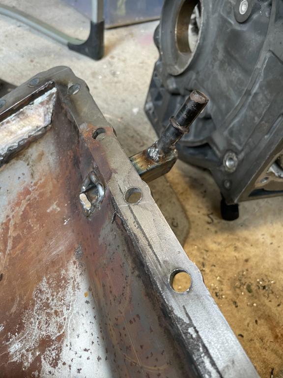

                      That bottom corner? I have to get a bolt in there to mate to a surface that's covered in weld... and it's still leaking. This sat for two weeks while I gritted my teeth and loved my dog, before I finally made it back out to add the last feature I needed, which was the drain for the vapor separator under the intake manifold:

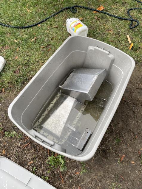

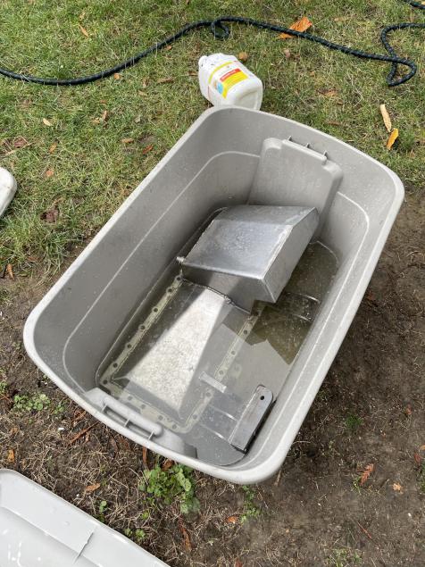

                      I did as much cleanup as I was ever going to (mostly to make sure I could get bolts in) and soaked the whole thing in a gallon of 30% HCL diluted with "that much" water:

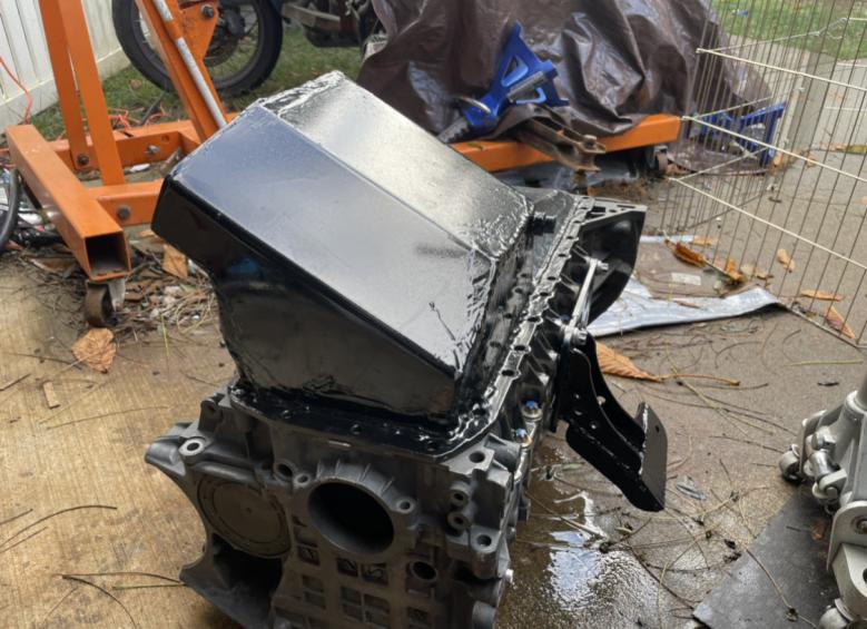

                      And painted the pan (on the outside) and arms in the dark... in the rain...
                      This should have been the best looking part of the project... but smearing 6 min epoxy with loose latex gloves and not caring about going back and finishing it or smoothing it... It's pretty globby. I just wanted to move on. On the other hand, I'll be shocked if this leaks, and it'll all be under the engine eventually anyway.

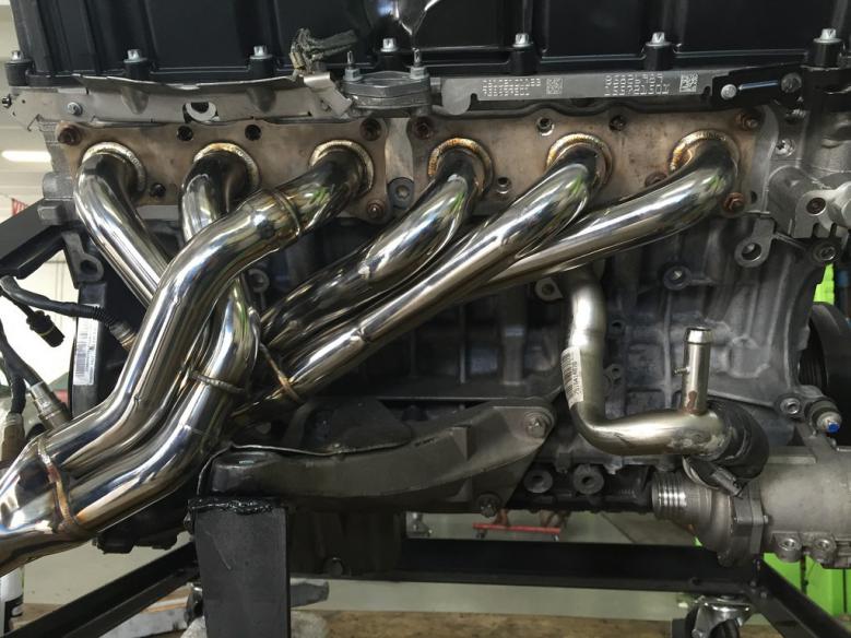

                        My impatience rolled right into the header project, because this is holding up the engine install now that the pan and engine arms are painted. ER308L wire tack welds pretty well with 75/25 gas. I couldn't find any sources that promised me it would, and I don't think I'll be doing more than tacks, but it worked just fine:

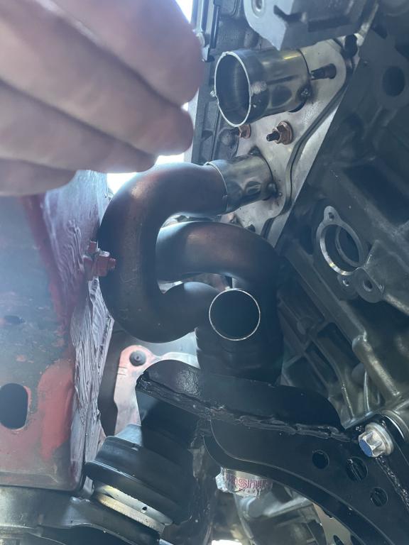

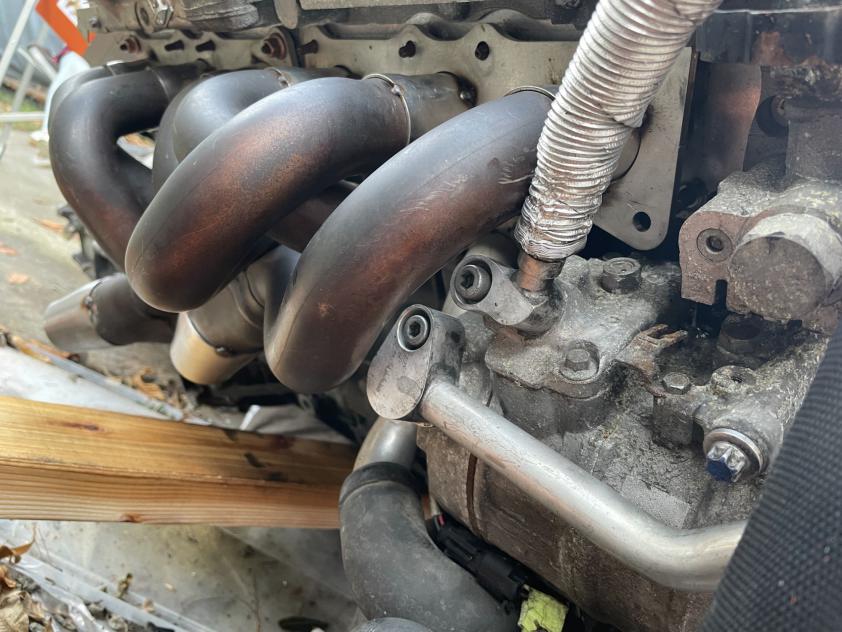

                        Until I went to mount the front bank on my engine and discovered a hopeless interference between the AC lines/compressor and cylinder 1:
                        This was a real stumper, but the compressor on the S54 shorter and/or further forward, with the lines clocked a little. I totally didn't see this coming. you can see how sharply #1 turns on the AA headers:

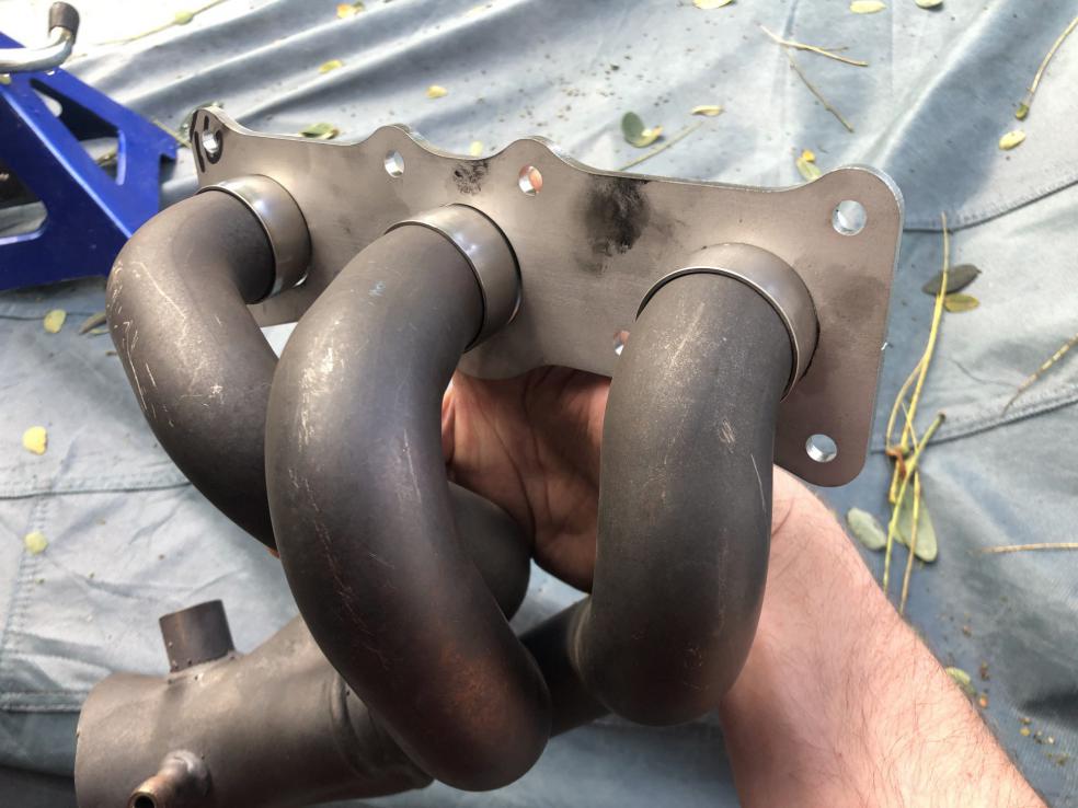

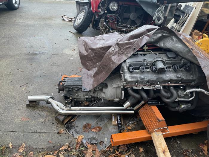

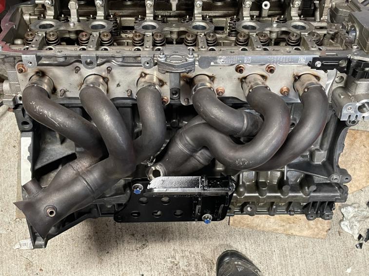

                          Copying a ton of other designs, I'm hoping to bring 2" secondaries back around the transmission like this, with a merge on the diagonal, to a 2.5" single pipe down the center under the drive shaft:

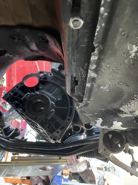

                          Working from both ends and seeing how much I had to make up in the middle, it looks like if the inboard secondary passes right under the transmission bolt slot, there's just enough room for the other secondary before it hits the radius of the heat shield under the floor pan:

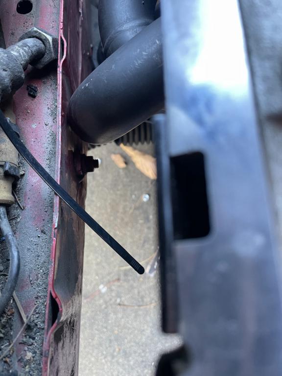

                          With the dummy block and head transferred over into the engine bay... tragedy once again befell the front bank headers. This is just kissing the inside of the frame rail with the #2 primary:
                          Dammit. This is forward in the rail from the crossmember, and forward of the front suspension. There's about 1/2" clear between the block and the cylinder 3 primary (you can see that in the photo above) so the current plan is to notch the frame rail and provide clearance with a 2" or 2.5" tube welded in to create room for the sweep. Normally this would be a deal-breaker (I don't love modifying frame rails) but in this case we're in the part of the frame that's already dimpled as crash-absorption. It's only holding the bumper and radiator core in place. I know I'm being stubborn with not modifying other chassis-side components like the sway bar and CABs, but I consider the headers completely optional... you could do this swap with factory north american manifolds and not run into this problem:

                          Other than that, you can see that it at least looks possible to run the front bank straight under the trans mount rail, with the rear bank kicking out and then turning back to just miss the CAB heat shield:

                          Before anything else exciting happens on the engine, I expect I'm going to need all of this worked out. For the first start (and until the engine goes in the other car) I can just turn down the last 45 towards the ground. If this doesn't get figured out now my only option is to run the open shorty headers and then try and figure this out when I have a transmission in the way and can't lift the head off (there's NO way these pieces are going to feed in with the engine in place).

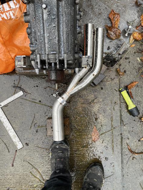

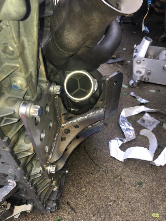

                            to get this fit, both of the collectors were cut just behind the cone, and just in front of the factory O2 bungs (which were the wrong type for our O2 sensors anyway), and the front cone has 9 degrees of kick out under the tape to bring it away from the block:
                            Here's what that looks like from above:
                            I did NOT think I'd be putting this much effort into the exhaust system...dropping straight down from the 3-to-1 manifolds to a merge would have been waaaaaaaaaay easier, but I'm not planning on making any other performance modifications to the engine, so I guess this is worth it.
