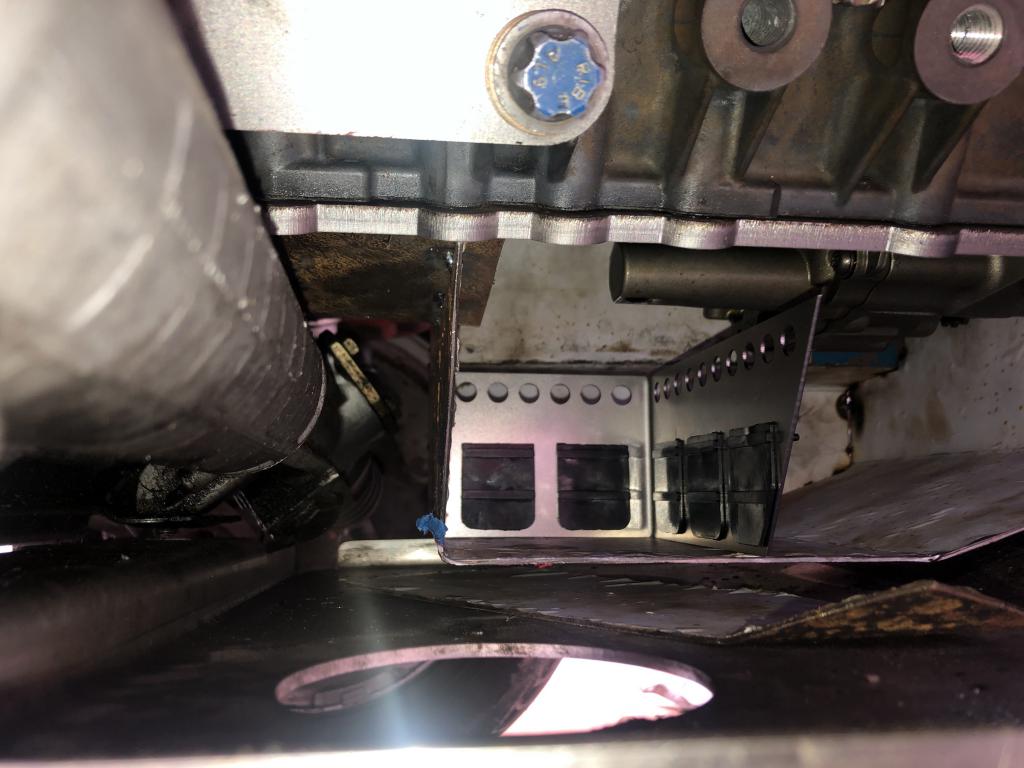

                    Plate arrived today to build the baffle and I couldn't stop myself from running out there to make one 90 deg bend:

                    The "near face" of the pan is lying on the skidplate below ready to go on when this is all worked out. There's a tray that needs a more precise bend that sits on top of this with an opening for the pickup to drop through.
                    I'd appreciate any input on whether this baffle design makes sense. effectively all engine oil is going to drain into the baffle area where it's captured by the flaps until it fills to the point of the overflow holes just below the tray. Whenever the oil level outside of the baffled area is lower than outside, it'll get refilled via the flaps.
                    I'm considering cutting every other "between piece" out between the overflow holes.

                      The only time I consistently saw my oil pressure light flicker was under heavy braking pointing downhill (on a rear sump pan).
                      I'm not sure you need any of the overflow holes?

                        Do you need that many flaps? most of the stock BMW pans I've seen only have one or two. 5 seems kinda overkill. But I've also never fabricated my own oil pan, so..

                          HG: Yep. I'm completely throwing out the rear sump as a reference and basically copying the design of the m20 baffles from advanced auto fabrication, bimmerworld, and achilles. They all separate the port side and front side of the pan from a corner in the "starboard/aft" where the pickup sits. I honestly don't think I need a baffle at all, but it's useful to drop it in there while this is all apart. Do I need any of the overflow holes? I dunno. after playing with these flaps I have a feeling that once there's some hydrostatic pressure against them they're a very good seal. My fear would be that unless I have overflow holes, there's no way for the oil to really ever get to the "rest" of the sump, so why do we even have it... I could see the baffled area filling up and just backing up into the tray below the crank. I think these are a much better seal than any hinged metal flap.
                          N: I think one or two would be fine... I think one on each of the flat faces would probably be fine... but I bought more flaps than I'll ever use, the holes are free, and this makes me feel better about oil not getting trapped in weird parts of the pan outside of the baffle. Once I saw the flaps on one BMW design, I started looking at the flaps in general cases. Cosworth doesn't screw around when they put them in Subaru engines:

                          The approach seems to be "put a piece of metal where you want oil to go one direction and not the other, and if there's room for a flap put a flap in it."

                            Which is separating each quadrant of the pan with solid baffling to "require" the oil to flow through the pickup well before it goes somewhere else (so rather than washing around the well, it's forced to fill it). Once I started looking at the shape of our pan, our pickup is already in a corner. I'm thinking about lining my oil drain plug up with one of the flaps so I can poke it in to drain the pan more completely during an oil change.

                              I think there's some comfort in the redundancy of multiple flaps, and I suspect that in static conditions they seep enough oil to keep everything equalized. Hot oil isn't very viscous so a few semi-circles at the bottom, or even just a small gap, should be plenty.
