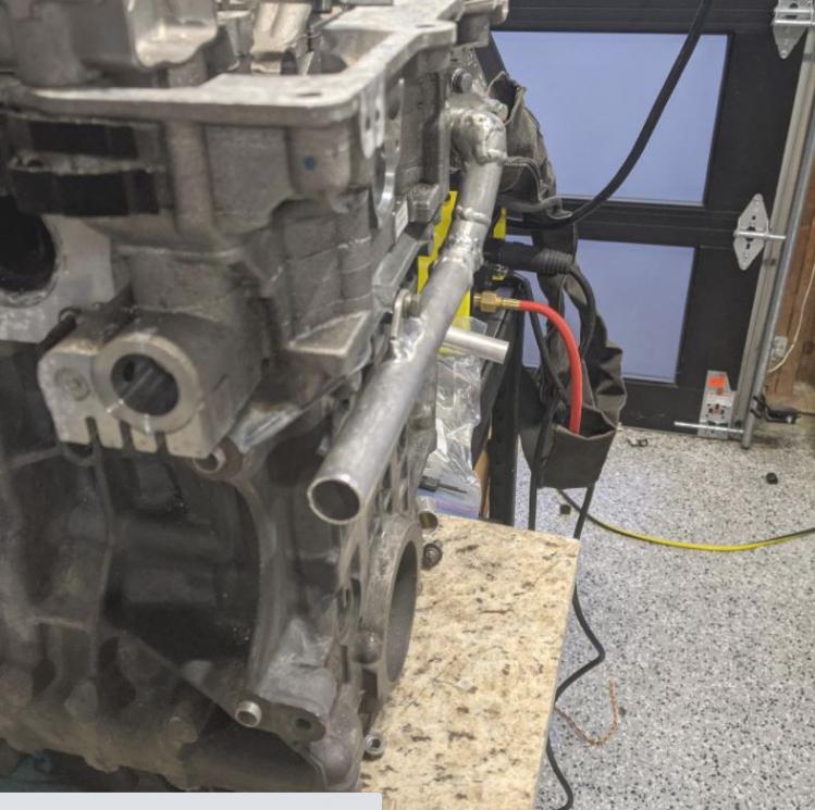

    Here's one of the big reasons whey everyone complains about radiator clearance on the N52. This is the coolant bypass hose, it goes from the "mickey" fitting near the regular radiator outflow to the "closed" side of the thermostat. The radiator connects to the "open" side. When the thermostat is cold, the radiator flow is blocked and the only flow is through this hose (and some through the heater core) to keep water circulating through the engine when it's cold. Once the coolant gets hot enough, the thermostat opens and it's a mix of radiator flow and bypass from this hose.
    It sticks out so far because it needs to clear the serpentine belt.

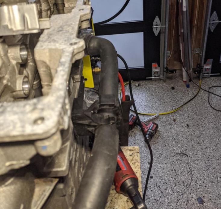

    I don't have AC, so I don't need the most of the serpentine belt, I'm only driving the alternator and power steering on the drivers side. Since there's a cheaply available aluminum fitting for the water pipe "mickey" (the stock plastic fitting dissolves after XX miles), my task has been to fab an aluminum hardline that could run closer to the block. I've made my second prototype and it checks all the boxes. Next step is to have a number of aluminum tubes bent to reduce it to one weld at the fitting.
    Clearance to the radiator is now basically limited to the profile of the cylinder head and the damper pulley. A 50mm radiator should be no problem, let along stock 33mm.
    I haven't decided if I want to use the second mounting boss yet. It's where the plastic hose-holder was attached.
