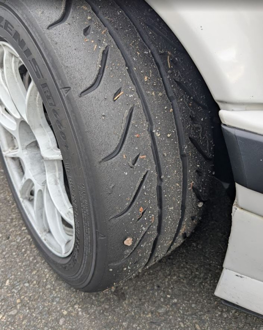

              I signed-up for Alfa Club twilight lapping last night and it was a good event as usual. Had a fresh set of Azeni 660+ tires that were pre-heat cycled and was impressed by them. I got to the event late and only got a few laps in the first session, but enough to scrub-in the tires. Quickly set a PB in my second lap of the second session, and then another PB well into the third session (2nd or 3rd lap is usually my quickest, so it's unusual that I'm fast towards the end of a session, but there was traffic...).
              Parts of the night felt like a DTM race, running with a Cosworth 190E...
              It's nice that there's not a single drop of fluid under the car in the morning. Just 100% quick and reliable!
              adam.nonis Is going to help me dial-up the power just a hair now. Still running the pedestrian DISA intake....

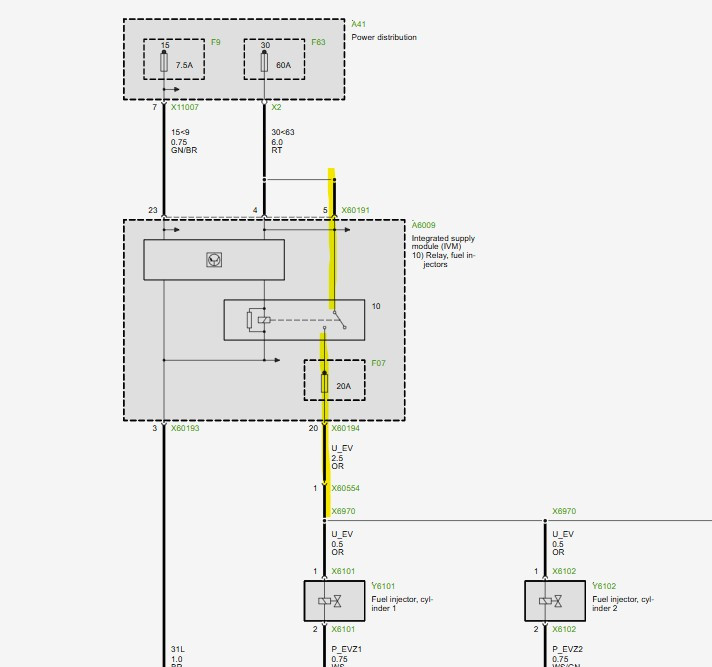

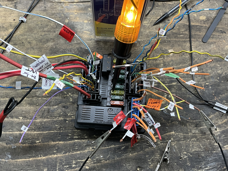

                  IVM Mystery.
                  Love this forum! This is my first post:
                  I’ve successfully installed an N52 into my S30 (which is a Datsun 240Z) With Kassel EWS deletes done on the DME, engine fired right up on an engine stand using the 330i engine harness and accompanying mess of relays and power wiring in the e-box.
                  Several of you have cleaned up said wiring mess with the Z4 IVM and so am I. On the workbench, I’ve been able to light up all the IVM fuses (except F7) by activating the DME relay and VVT relay. F7 is a mystery! It supplies power to the injectors from the injector relay which is integral to the IVM. It should be easy, I just can’t locate the activation signal. It’ll be switched power (not switched ground).
                  That switched activation power could come internally off “Run/Start” Pin 23 X691 but doesn’t. How is this relay activated?

                    #834
                    Originally posted by Nizzan
                    IVM Mystery.
                    Cool project!
                    It may be that you need to apply power to pin 5, which is the only place F07 gets power from. This is from the WDS online.
                    Yes! The IVM is a much cleaner solution than the hodge-podge of relays, fuses and wiring that jumble the E90 cowl.
                    Click image for larger version  Name:	Screenshot 2026-01-16 073402.jpg Views:	0 Size:	53.5 KB ID:	10154163

                      #835
                      Thanks Hoveringguy….It lights up now!

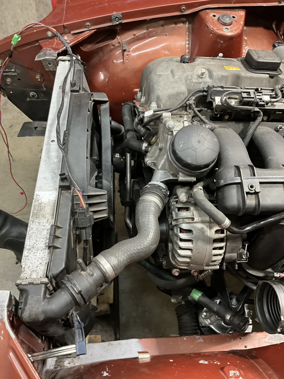

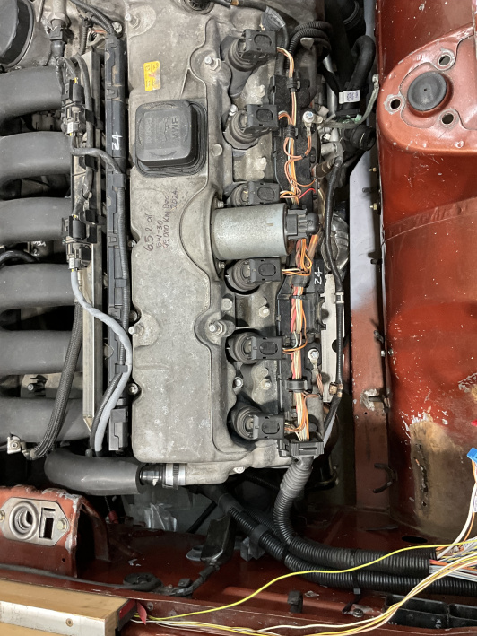

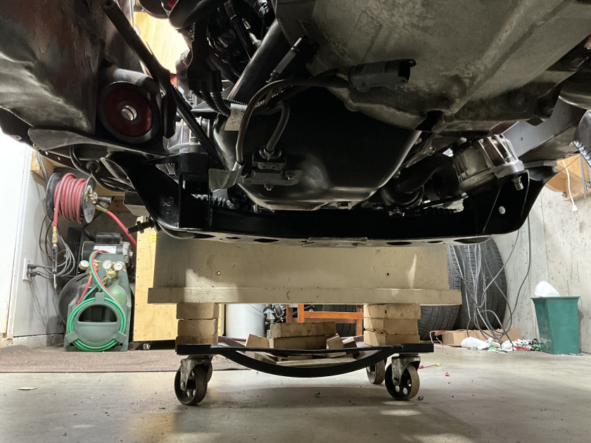

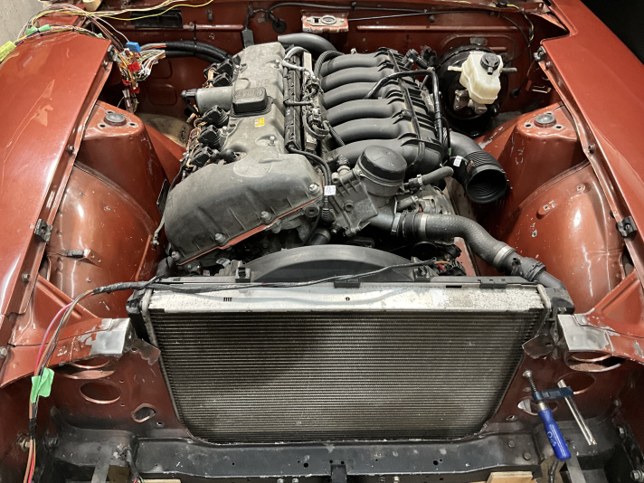

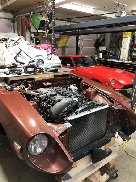

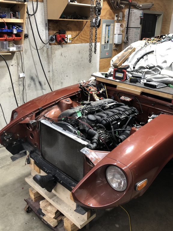

                        #836
                        A few more pictures…. I’m amazed by the ease in which this engine slips into the engine bay. Brake booster and 3-stage intake are quite happy together. Stock oil pan fits perfectly, Stock E92 radiator and fan assembly fit like a glove and without causing any fore and aft space issues. Hood clearance is snug but still allows room for the BMW beauty cover. I needed to buy 2 sets of AA style headers and used the 2nd 1-2-3 header section in the 4-5-6 position to get things to fit with minimal fuss.
                        I still have a long ways to go but feel like I’ve broken the back on this project. And so so appreciate the ground-breaking work you all have done with your E30 N52 swaps.
                        I hope to tap into this community from time to time and would happy to share my progress occasionally.
                        Thanks!
