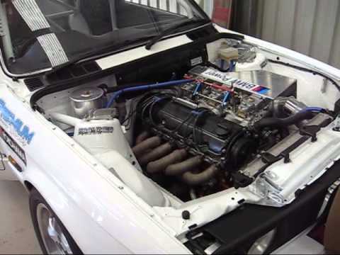

              Well I'll be damned..... I did some digging and that Victoria/Weber 2.8L is 14:1, and I think these are the exact pistons that they used in this motor. See below for a shot of their JE 14:1 piston.
              Picture085_zps5d36ad21 by Bobbie Morrone, on Flickr
              1989 Hooptie 325iS Build Thread
              1989 Zinnoberrot M3 Build Thread
