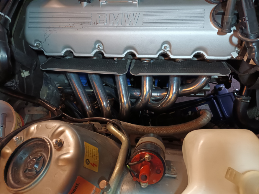

    i got a longtube header in and screwed up the paint on my valve cover while doing it.
    Click image for larger version Name:	20231106_102430.jpg Views:	0 Size:	221.7 KB ID:	10109389
    don't ask. i opted to install after the engine was in instead of hanging them prior. have no clue if it was the right decision.
    did get them in.
    Click image for larger version Name:	20231106_103523.jpg Views:	0 Size:	214.2 KB ID:	10109391

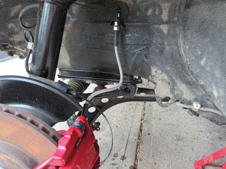

    at some point i managed to clean up and rebuild the brakes and added in some stainless lines.
    Click image for larger version Name:	20230807_143252.jpg Views:	0 Size:	218.7 KB ID:	10109393
    that one was easy. getting the 2 small lines in above the rear sub was no fun.
    don't mind the rusty rotors i have replacements.

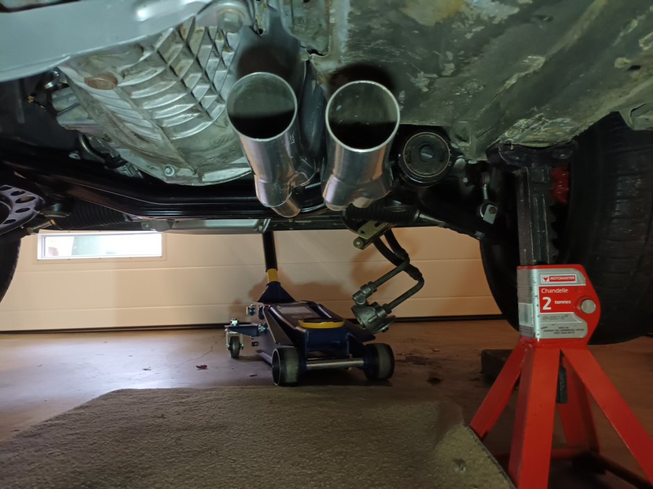

    Howz the ground clearance with the collectors? do you have a height difference measurement to the bottom of front sub frame i.e. how much below the front sub frame does the collector (merge) it hang?

      actually not as bad as expected. they sit higher up than stock, clearance is tight but doable. it don't think it really comes any lower than the frame rail. the car's on h&rs so is probably dropped about an inch +. i can reach though the engine bay and touch ground from above. the bell housing is lower than the headers at the firewall.

        Which headers are those? They seem to fit a lot nicer than the headers I have.

          IE long tube. bimmerheads sold them as well but they all seem permanently out of stock. i tried to get them from bimmerheads but they could not supply and told me to grab the last pair from IE last winter. i've had them a yr or so before i hung them.
          they are supposed to be an improvement over the shorties. i figure my car could use anything i could get. it's a pretty mild build.

              these are tight getting past the cab as well. i removed the heat shield to install and reshaped it a bit tighter to get back in. i'm getting a custom mid built and i'm running a stromung out back as well.
