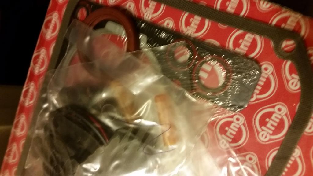

          I'll get right on it. .. I have a VR and an Elring I can snap a photo of.

                Thanks digger, I misplaced my VR gasket. Close up of the elring
