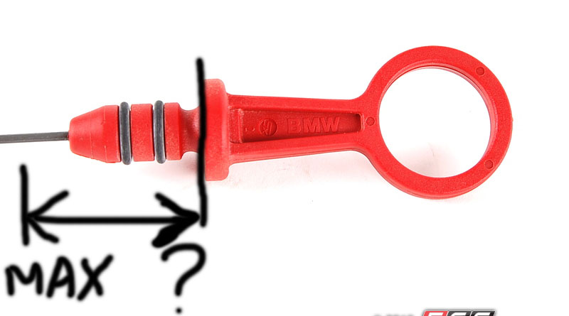

          Someone with a genuine M42 e30 can give me the distance from top of dipstick to maximum level please? Like in picture.
          Thanks in advance!

            #710
            14 1/4 inches

              #711
              Thank you very much! I was running low on oil, maybe your help will be good for saving my engine :)
