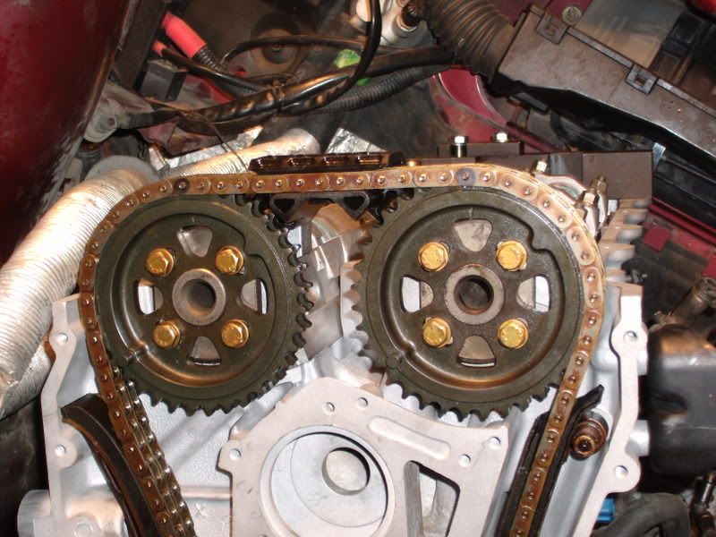

        Verify that not only is valve timing correct (I read you have done that part), but that the sprockets are oriented correctly with relation to the cams.

          #64

            #65
            Originally posted by theTBLACK
            The sprockets as in the two wheels with the surrounding chain at the front of the motor? How would I go about doing so, and how will I know they are in the right position?
            Yep. Verify that with the engine at TDC and the cams in their TDC position, the timing marks on the sprockets are in this pictured position and the trigger dowels are present, intact and at the ~7o'clock position.
            If your fuel injectors are firing and your spark is strong, it's down to timing. Something isn't occurring when it should, we just have to find what and why. While you're at it, you may want to also verify the crank pulley's position with the old "long wooden dowel down the #1 spark plug hole" trick by checking that the timing mark on the pulley and timing case are aligned when the TDC position is indicated by the movement of the dowel. I'm not trying to imply that you don't know how to do this stuff, just putting out there what I've seen happen to others.

              #66
              Mine looks exactly like that first photo. Tick marks straight up and down.

                #67
                Are the cams AND crank in the TDC position together? The cam lobes for cylinder #1 (front-most one) should be pointing up and in when piston #1 is at the top. I am guessing that maybe piston #1 is at BDC when the cams are at TDC.
                Check out the diagram in my other thread (last image in the first post). It spells things out very clearly. You want everything positioned shown to the left of the image for Cylinder 1 TDC for Power Stroke.
                  http://www.r3vlimited.com/board/showthread.php?t=374858
                  The cams are in the same position as the diagram you referred to - Cylinder 1 TDC, and the tick mark on both sprockets are pointing straight up, like the photo posted previously.
                  Is there a way that the cam lobes and ticks are in the right place, but the piston at BDC?

                    #69
                    Yeah, you could have gotten the crank 180 degrees off. IIRC the stock flywheel has 2 holes for the alignment dowel, so it is possible to mix things up that way. Pull spark plugs 1 & 2 with the engine at TDC and make sure that piston 1 is above 2.
