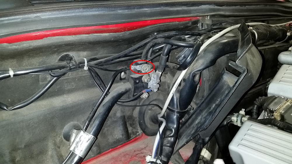

                Not quite following. So the fuel pump does NOT run when the ECU is connected, but it does run when you jump something with the ECU removed?
                Here's one more thing to check. Sort of obscure, but it has happened to people (including me about 10 years ago). See the attached image. You should see battery voltage (11-14V) on the circled terminal. It is a dedicated power line for the ECU and all injection electronics. There is an inline 50A fuse on the smaller of the 2 wires that comes off of the battery's positive terminal, and sometimes it gets corroded and will start breaking continuity. Probe between the circled nut and ground to see what voltage you get. If you have a friend nearby, have them go in the trunk and shake the big black wires coming off of the battery while you measure.
                If that doesn't yield anything, it's time to probe other stuff. Check to make sure that you see battery voltage on relay terminal 87 of the main relay. Since you need the ECU and main relay plugged in to do this, you can unplug the ICV and probe terminal 2 in the harness plug since that is connected to the main relay's pin 87. See diagram 1360-1 in the wiring diagram PDF that I linked you to previously. When probing, turn the key to Run position and it should turn the relay on.
                If that checks out and the ECU is enabling the main relay, next you can check the fuel pump relay. It's output goes to fuse 11, so see if you get a 12V blip on there when you turn the key to Run mode since I think the ECU primes the pump when you do that.
                Other than this stuff, I can only think that maybe a wire got damaged somewhere. You said you have had wet plugs during earlier checks. Try replacing fuse 11 (or grab a different one to test quick if you don't have a spare). Sometimes they get a hairline failure and intermittently make contact.
