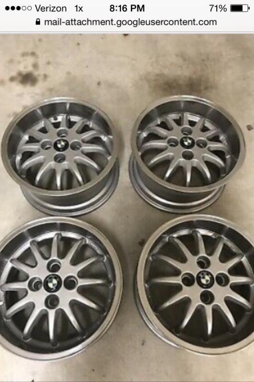

                Will these Artec's fit on my '88ix?
ID:	7201715Thinking this might be as close to German aftermarket direct fitment for an ix? I might find?
                Specs. 88ix with Blistein/ HR sport so lowered just a tad.
                15x7 4x100 cb 57.1 et38
                Artec made in Germany unknown year.
