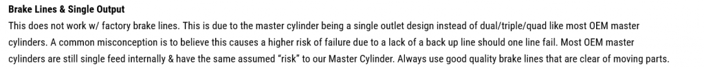

                  Never replace an OE style system with something like the chase bays single circuit master cylinder, it has no redundancy and chase bays outright lies on their website (see below) about the inherent safety of the product. I have covered this before. Not only are most OE reservoirs and master cylinders made in the last 50 years divided but even if you were to completely empty the reservoir and drain one circuit, the other circuit will contain enough to stop the car. Anyone who has ever had a master cylinder apart knows how they are internally constructed.
                  Click image for larger version  Name:	Screenshot 2022-08-01 at 18-00-26 Chase Bays Single Piston Brake Booster Delete - BMW E30 2002 E21 E28 E34 Porsche VW.png Views:	0 Size:	69.7 KB ID:	10063830
                  There are dual master cylinder pedal boxes and brackets that contain two separate master cylinders with a bias adjuster that bolt on where the booster does, this is the typical configuration for cars that lack a modern boosted system for some reason, like some race cars.

                    Why do chase bays offer single circut master cylinder? surely there is a suitably sized dual circuit?
                    i'm not sure what the rules are like in USA but converting from dual circuit to a single circuit in Australia would be completely illegal with no way of getting it engineered etc.
                    I'm not against booster-less but yer it wants to be a proper pedal box with 2 master cylinders and the ballance bar and alot of testing to make sure its working right, not some half assed swap out job. Ive driven one properly setup boosterless dual master setup in a kit car, and it was pretty great but would get very tiresome as a daily drive or even weekend car.
                            Their target customer base is the stance crowd, vape and scrape. It's no surprise that people who stretch tires until they're ready to debead from a pothole, completely fuck suspension geometry up for a trite aesthetic, butcher fenders and scrape up undersides of otherwise nice cars, would also believe some slick marketing man's hollow words about how somehow the two fittings on his brake reservoir still lead to one internal passage or something.

                              hmm fare enough. they will probably do quite well in business then! hah
                              Isnt this one dual master? Lots and lots of woffle isnt helping their case, but the built in brake bias controller is pretty neat.
                              600usd though, getting close to a tilton setup or similar.
