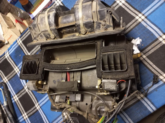

                                Do you have documentation or electric diagrams for the automatic climate control and automatic air conditioner?
                                It was installed in European E30s.
