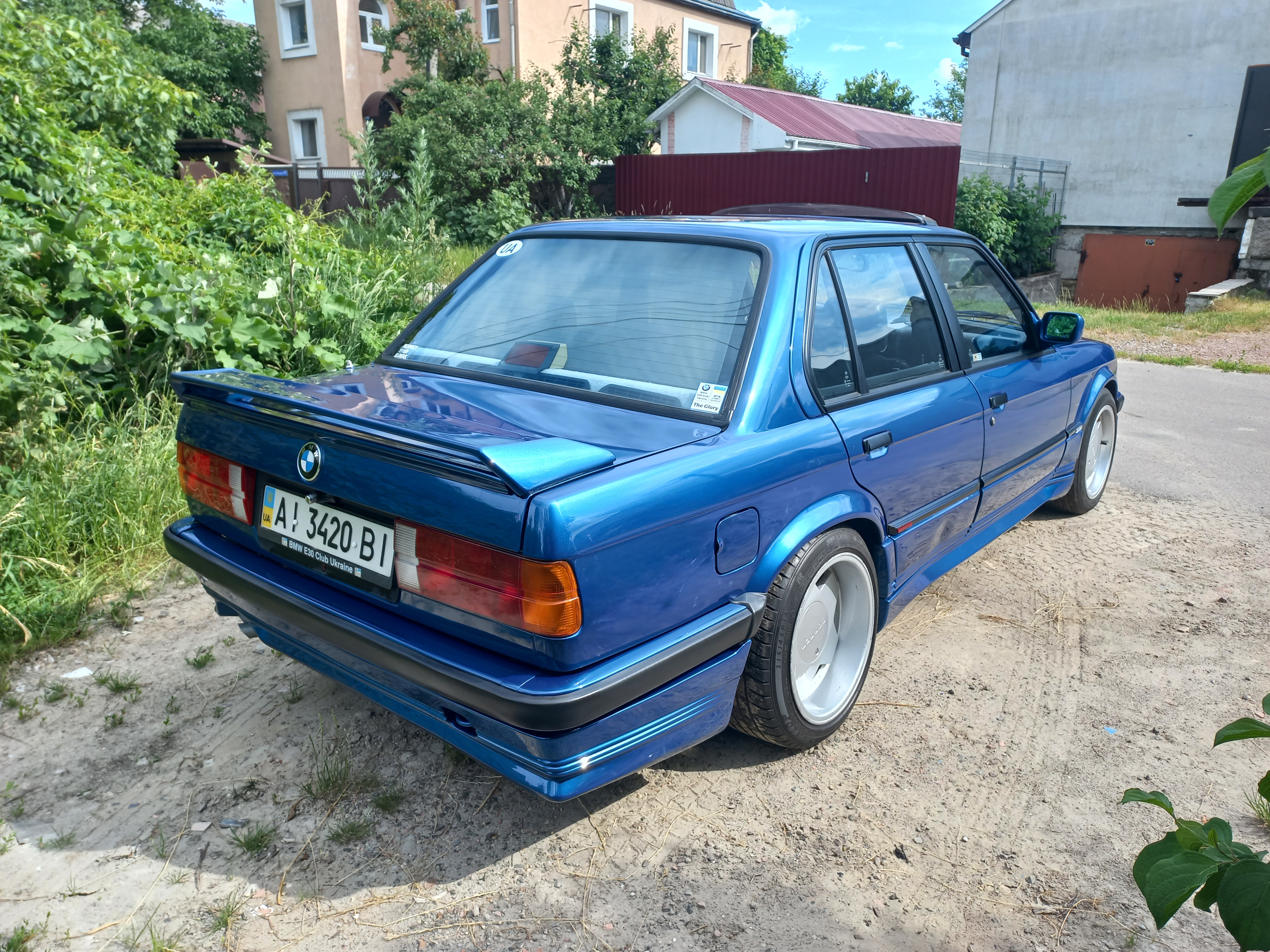

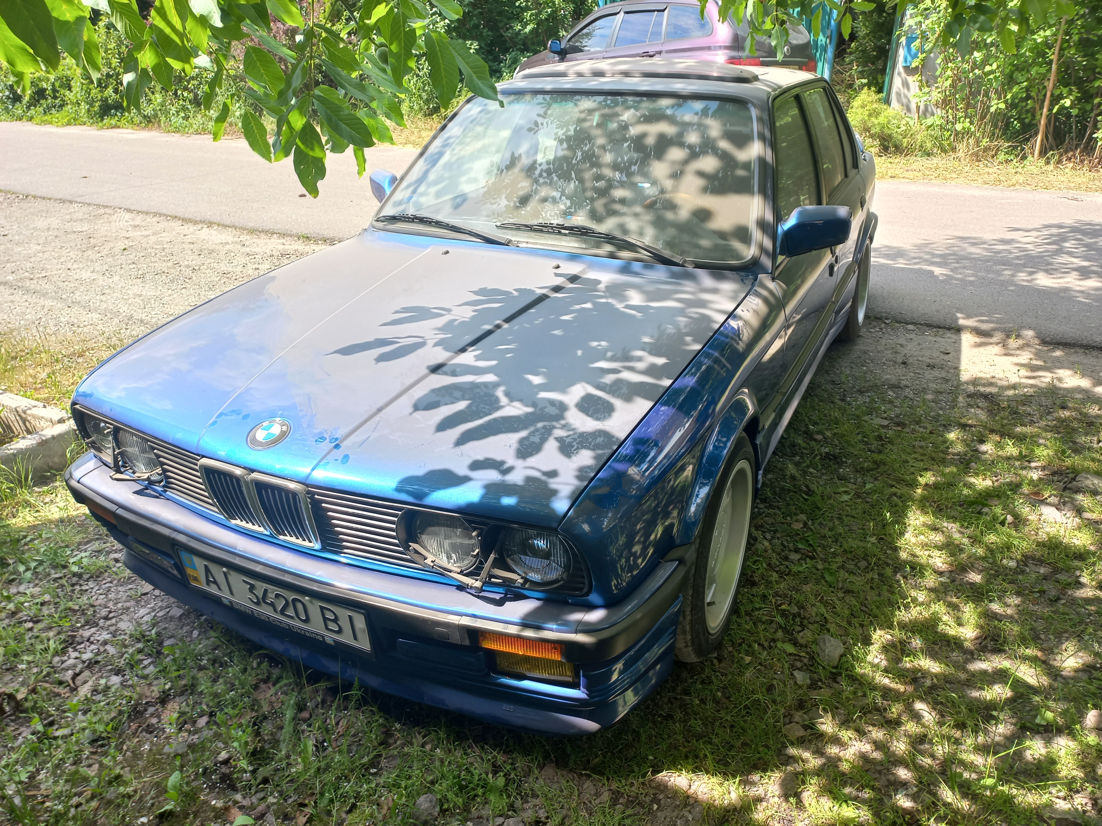

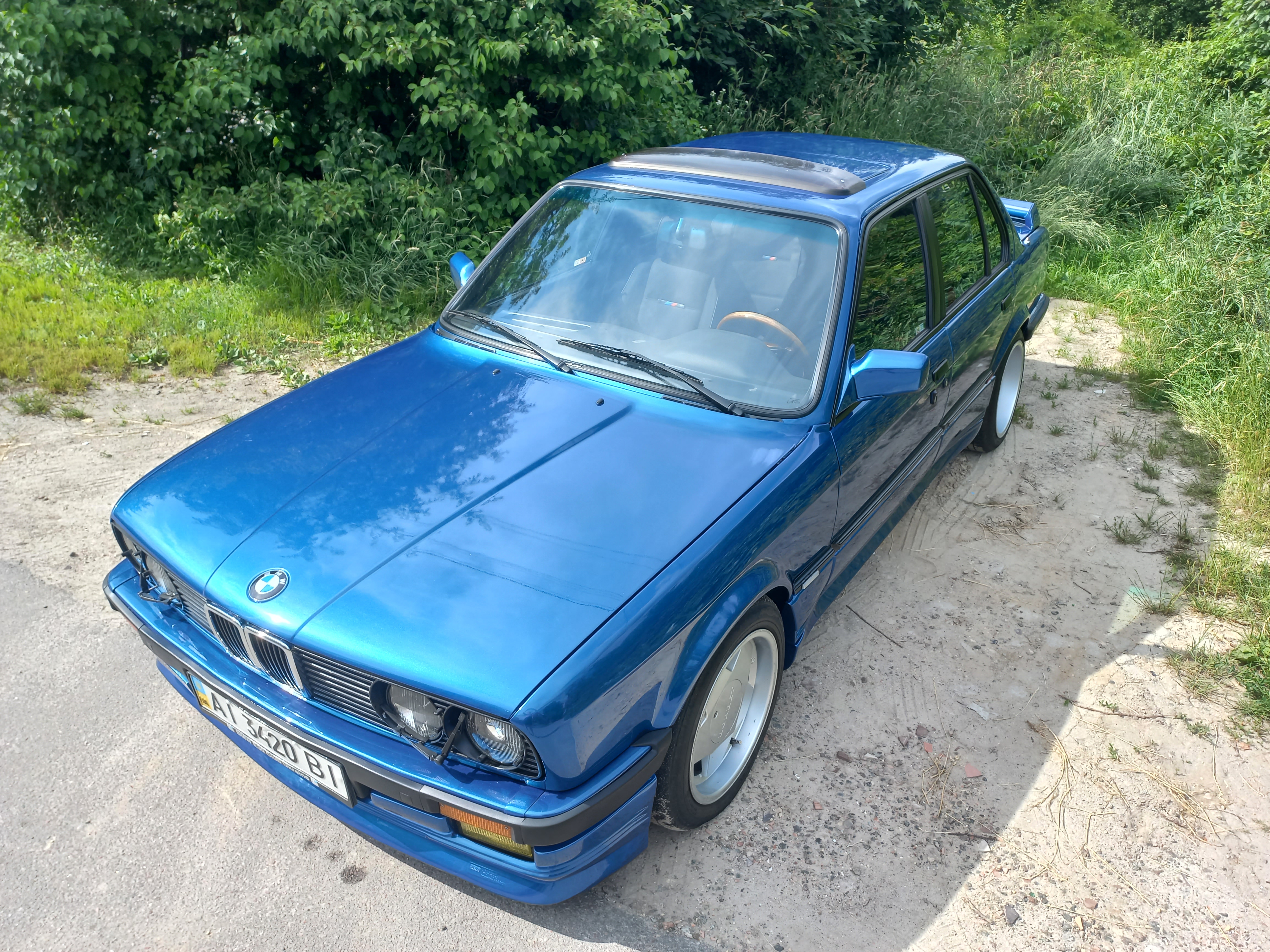

                            First "photoshoot"
                            I found a "time capsule" that had been sitting in a chicken coop for 40 years! )))
                            Just kidding )
                            My garage is really dusty.... (
                            Washed away from "age-related" dust.
                            And finally, a spontaneous improvised first "photo shoot" of the fully assembled car!
                            [IMG]https://i.ibb.co/Fq3R5yhV/20260624-162132.jpg[/IMG ]
                            Not everything turned out perfectly, but it looks beautiful, as far as I'm concerned! )
                            I drove it a little - the car on the road attracts the attention of others!
                            It gives positive emotions behind the wheel! And that's the main thing. I've been waiting for this for a long time.

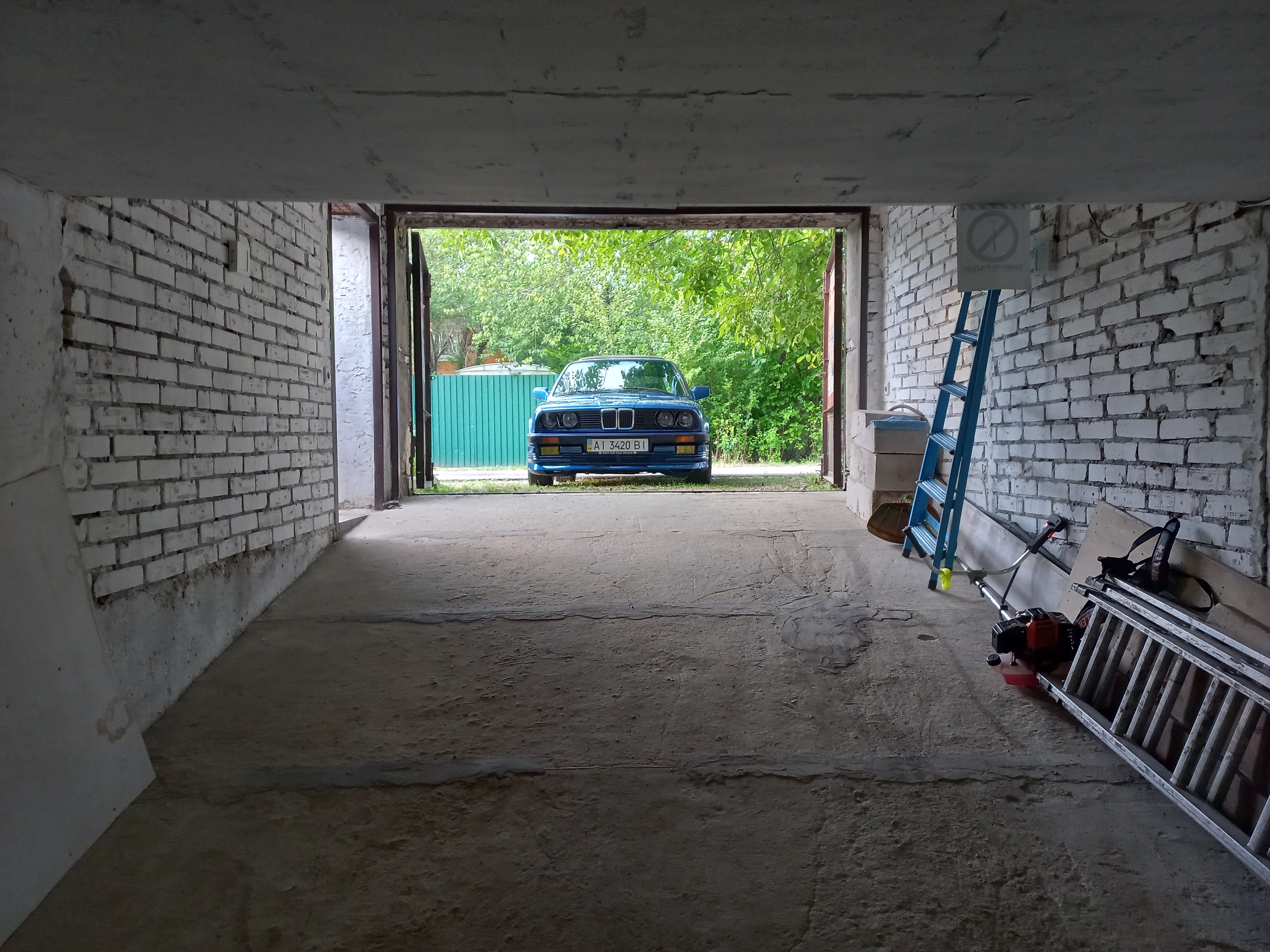

                                Nothing new...
                                So, almost a month has passed, but I haven't done anything with the car. The reason, as I said last time - the damn Muscovites!
                                Well, in the house, the windows, the doors, the roof, the gate, the roof and the gate in the garage - everything has been restored. Well, almost everything... almost restored... But, thank God, it all ended like this.
                                I can also get back to working on the car. It was in the garage, so, fortunately, it was not damaged. It was only slightly sprinkled with plaster from the ceiling and sand from the floor from the explosions.
                                I recently left the garage to wash it all off.
                                I washed it very carefully so as not to damage the paint with plaster and sand. Because it may not live to be polished....
                                By the way, - a new roof in the garage ) I've been wanting to do something with it for a long time - but the damn Muscovites "helped"...
                                I washed it.
