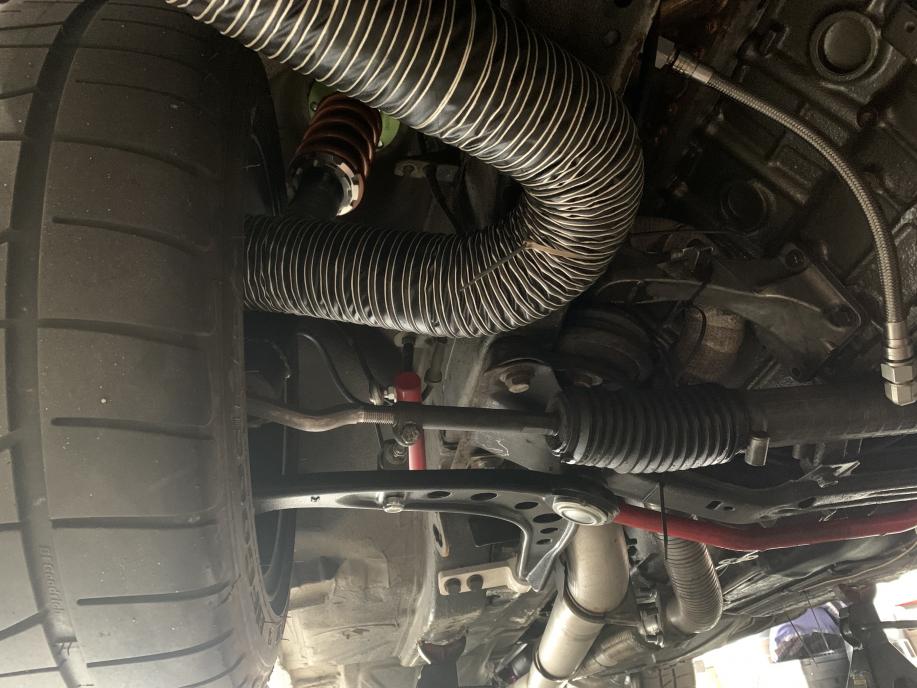

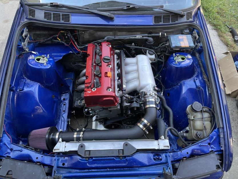

    Long time viewer of this forum, but have never posted anything! I figured I would share my car, which is a result of 7+ years of modifying, breaking, fixing, tracking, and most of all, spending money like its going out of style. Say hello to my 1991 "324is" ;)
    Instagram: @Matty_E30
    Drivetrain:
    2007 Honda K24a2 engine
    KPower Industries swap kit
    ZF 5 speed transmission
    OEM E46 330i clutch
    S2.93 LSD (swapping to shorter final drive soon)
    Suspension & Brakes:
    Feal 441+ Road Race spec coilovers, custom valving w/ Swift springs
    Garagistic bump-steer adjustable tie rod ends
    Garagistic Spec E30 front sway bar & adjustable endlinks
    UUC front big brake kit, 11.75" two piece rotor with Wilwood 4 piston caliper
    Z3 steering rack
    CondorSpeedShop LCA solid mounts
    CondorSpeedShop rear subframe bushings, RTABs, and diff bushing
    Exterior:
    Ford "Deep impact blue" paint
    OEM body panels, the way god intended
    Custom front splitter (coming soon)
    NLR E30 Big Wang kit (coming soon)
    Tascar3D headlight intake
    Tascar3D brake ducts, fully functional
    Tascar3D reflector blanks
    Wheels & Tires:
    Konig Dekagram 15x9 all around with 245/40r15 RT660 (track setup)
    Rays Gramlights 57DR 15x8 with 225/45r15 RS4 (street setup)
    Interior:
    Sparco suede steering wheel
    Sparco EvoII drivers seat
    Sparco Sprint pass. seat
    IRP chassis mount short shifter
    Tascar3D vent gauge pod
    Tascar3D check panel delete
    Electronics & Management:
    LINK ECU HC20x stand-alone
    KPowerIndustries K-swap RWD harness
    KPowerIndustries E30-to-K chassis adapter harness
    AiM Solo2 GPS lap timer with ECU CAN-BUS integration
    Engine Specifics:
    2007 K24a2 RBB out of Acura TSX
    OEM Honda internals
    New OEM rod and main bearings
    New OEM gaskets
    KPower RWD Intake manifold
    Modified S2000 exhaust manifold
    AC/PS deleted
    KPower throttle body with E30 wheel
    Modified E21 throttle cable
    Retained OEM IACV
    8300 rpm redline
    KPower baffled oil pan
    KPower oil pickup tube
    RSX Type-S oil pump
    KPower K-to-ZF adapter plate
    Koyorad E36 radiator
    K-Tuned FPR
    EP3 idler pulley setup
    215 WHP / 180 WTQ on 93 octane

    look at all that space !
    bet it was fun. glws.

            Pretty cool. There's actually one here at work right now hehe.... LINK
            That battery tray shows signs of turbo action in the past lol.

              Good eye! Before this swap, it was turbo M50 swapped. It was a lot of fun and very fast on the straights, but unbalanced in the corners!

                      I love an engine bay that's been breathed on.
                      Maybe you can figure out an alternate coolant overflow tank and move the air filter to the other side? Would clean things up further.
