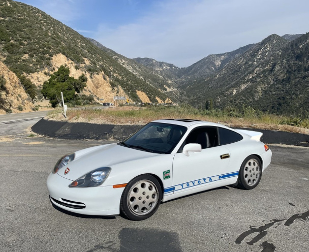

              “Fun” Update:
              Finally had a few minutes last night to sneak into the garage to see if I could discover what gave me the heebeejeebees last weekend on my weekly Malibu canyon run. The car cut out for just a second and my diagnosis on my way home was a loose ground somewhere. So now with the booty off the ground I was poking around looking for something. Factory ground cable was good and tight so the search continued. Eventually I spotted it tucked on the passenger side. No idea what this is a ground for, but there’s (I believe) 3 grounds here. One looks like it had already broken in the past and was butt-clamped together and everything got wrapped in electrical tape. It was quite crusty so this isn’t a new repair.
              After unwrapping I found a broken brown wire , and our likely culprit. Not sure what this is a ground for, but it’s there for a reason. It’s also in a horrible spot so the repair won’t be fun. “Luckily” I still have some “fun” work ahead of me in replacing the AOS with the UAOS... might just hand this fun job to someone else and deal with the “fun” bill that awaits me...
              In actual fun news, while I was down there I discovered why my exhaust seems to sound quite good. Looks like a gondo hack was done by a previous owner. Might help resale value when I pull these off lol

              • roguetoaster
                Biggus Tippus
                • 7830
                #52
                ​​Click image for larger version
                Per tradition.

                  #53
                  Dang, I was going to keep the MR2, but sh!ts tyte yo

                    #54
                    [QUOTE=roguetoaster;n10101186
                    Per tradition.[/QUOTE]
                    Those headlights look better than the eggs lol
