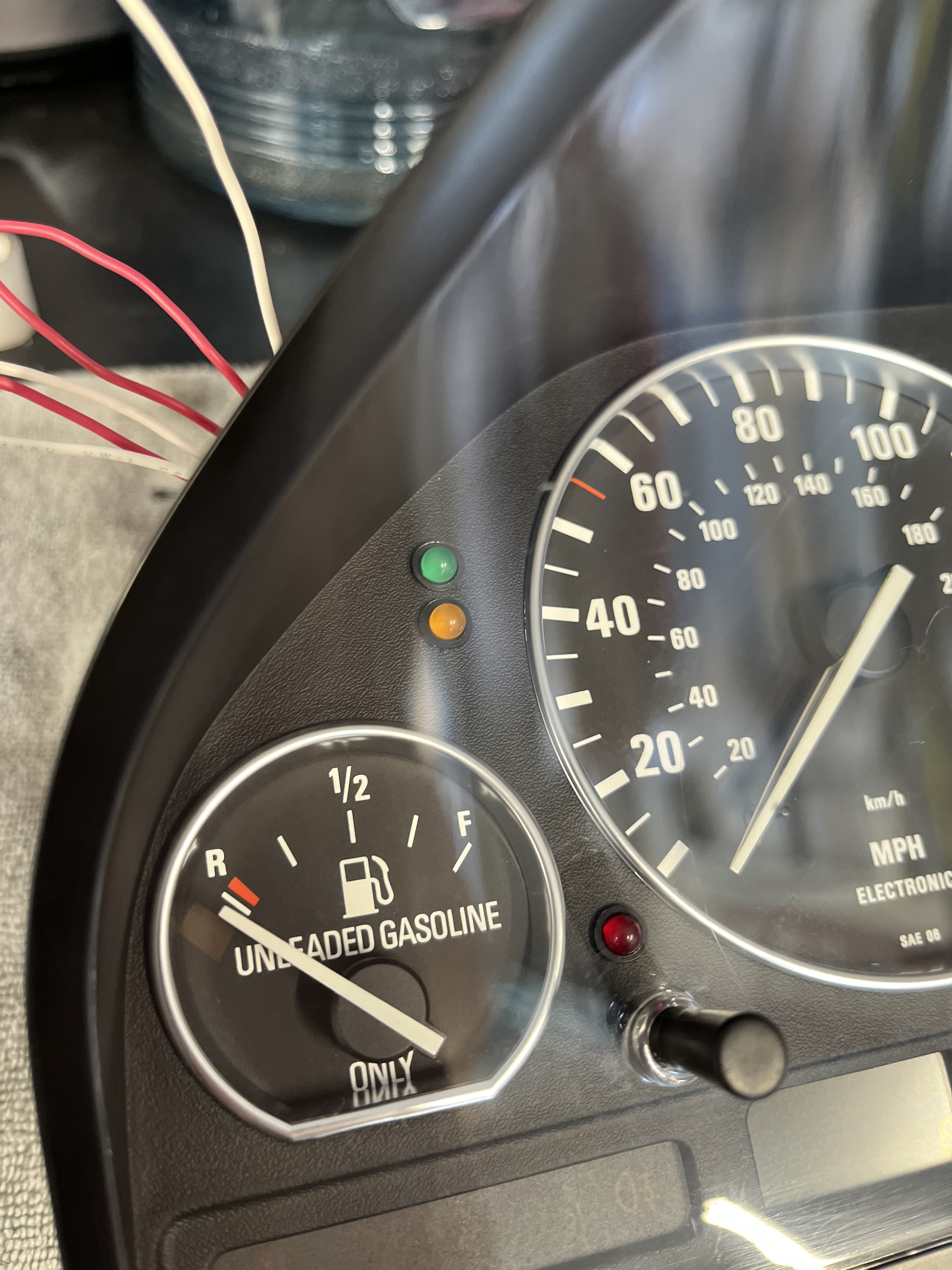

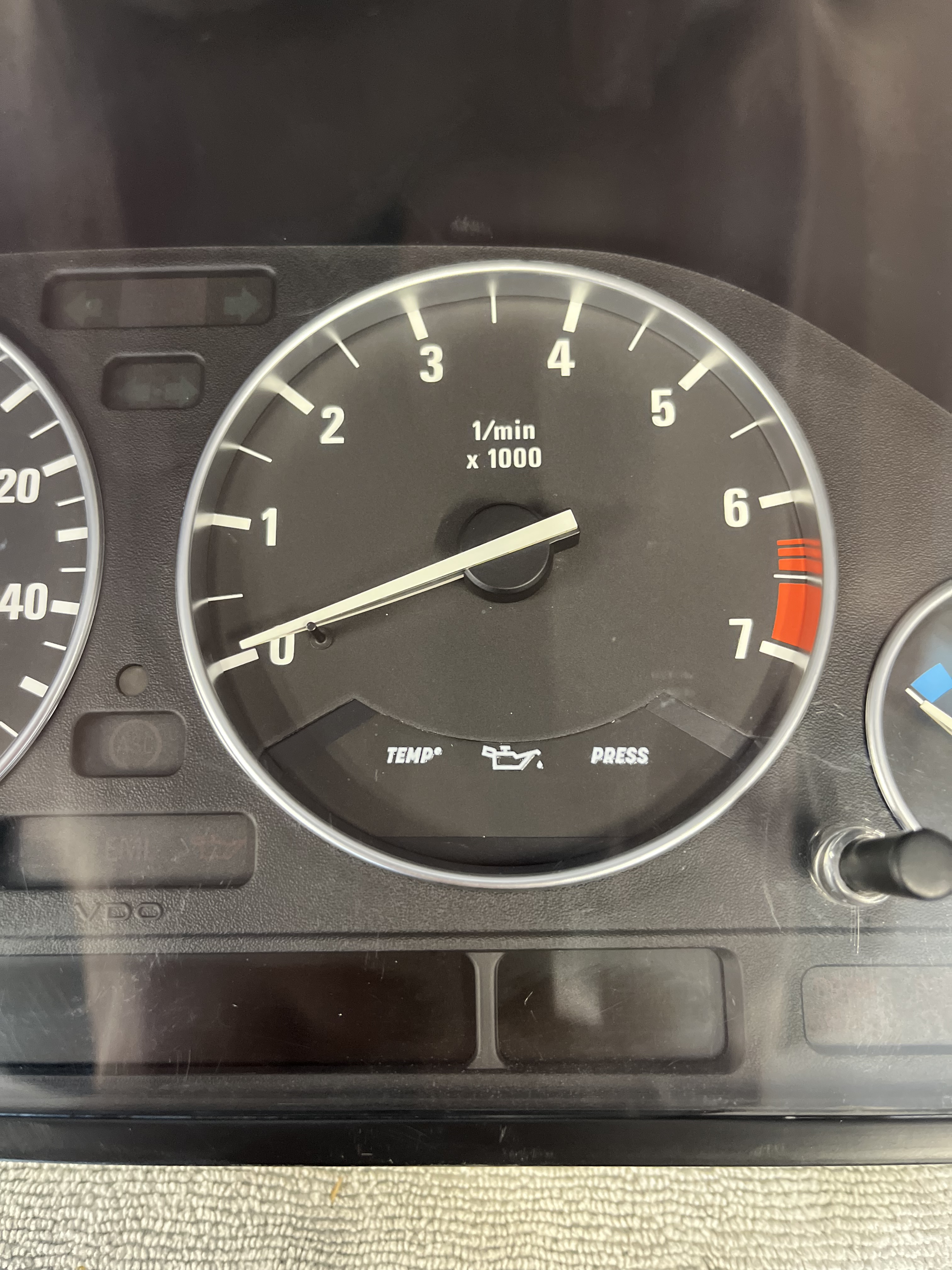

          In the meantime, I put the meth LED lights into my cluster. I also got wind of a company called My Classic parts. They sell a slick E36 specific oil temp and pressure digital gauge that swaps into the cluster in place of the eco-meter. I bought one, thinking it would be easy to install in an E34 cluster. LOL
          It was not. It took me about 6 hours to do this. Worth it imo.
          My Eco- meter no longer works because I needed an output channel to run my methanol solenoid.
          I wanted this badly so I hot knifed my RPM gauge all to shit. Here are the final results.

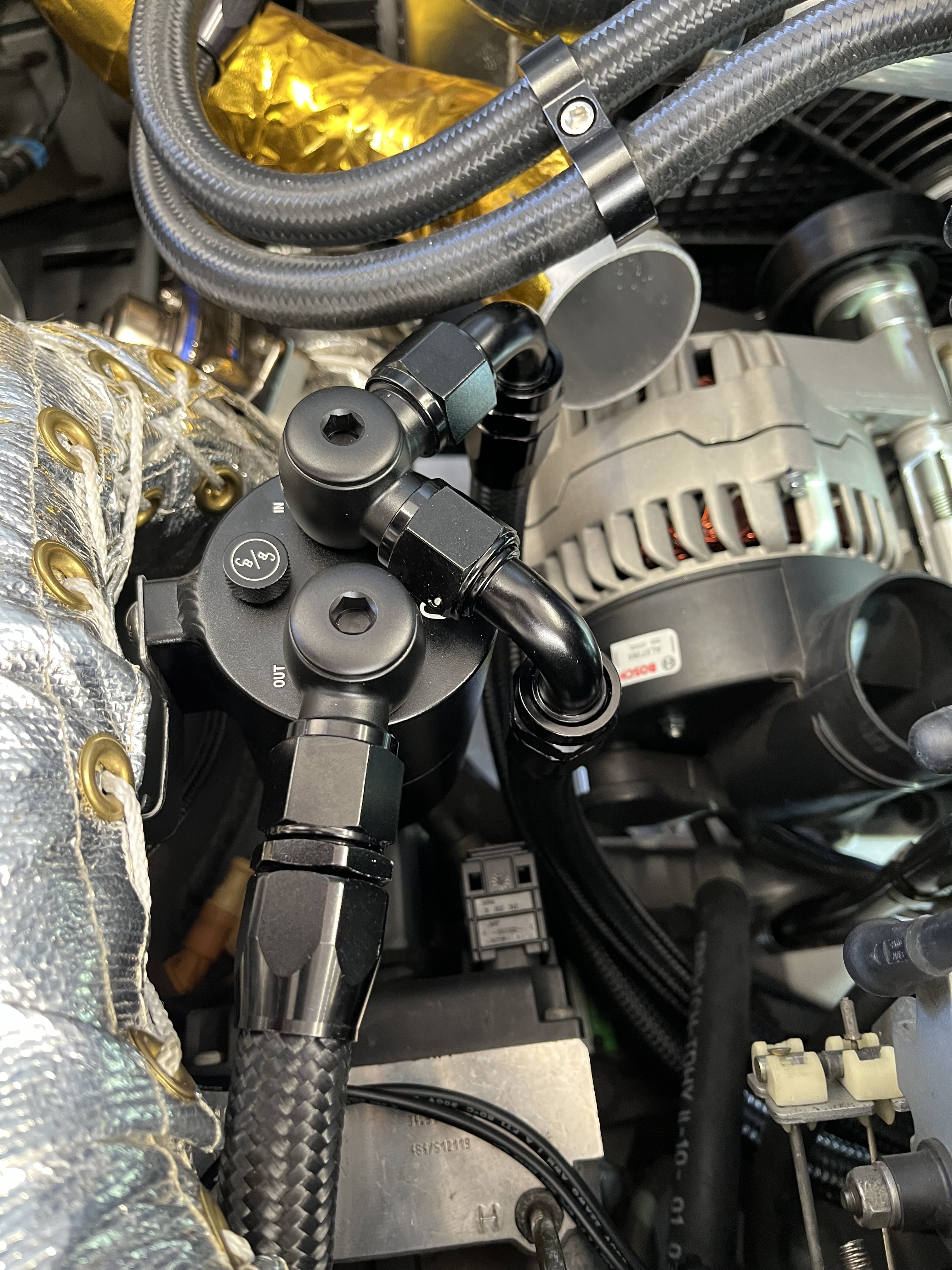

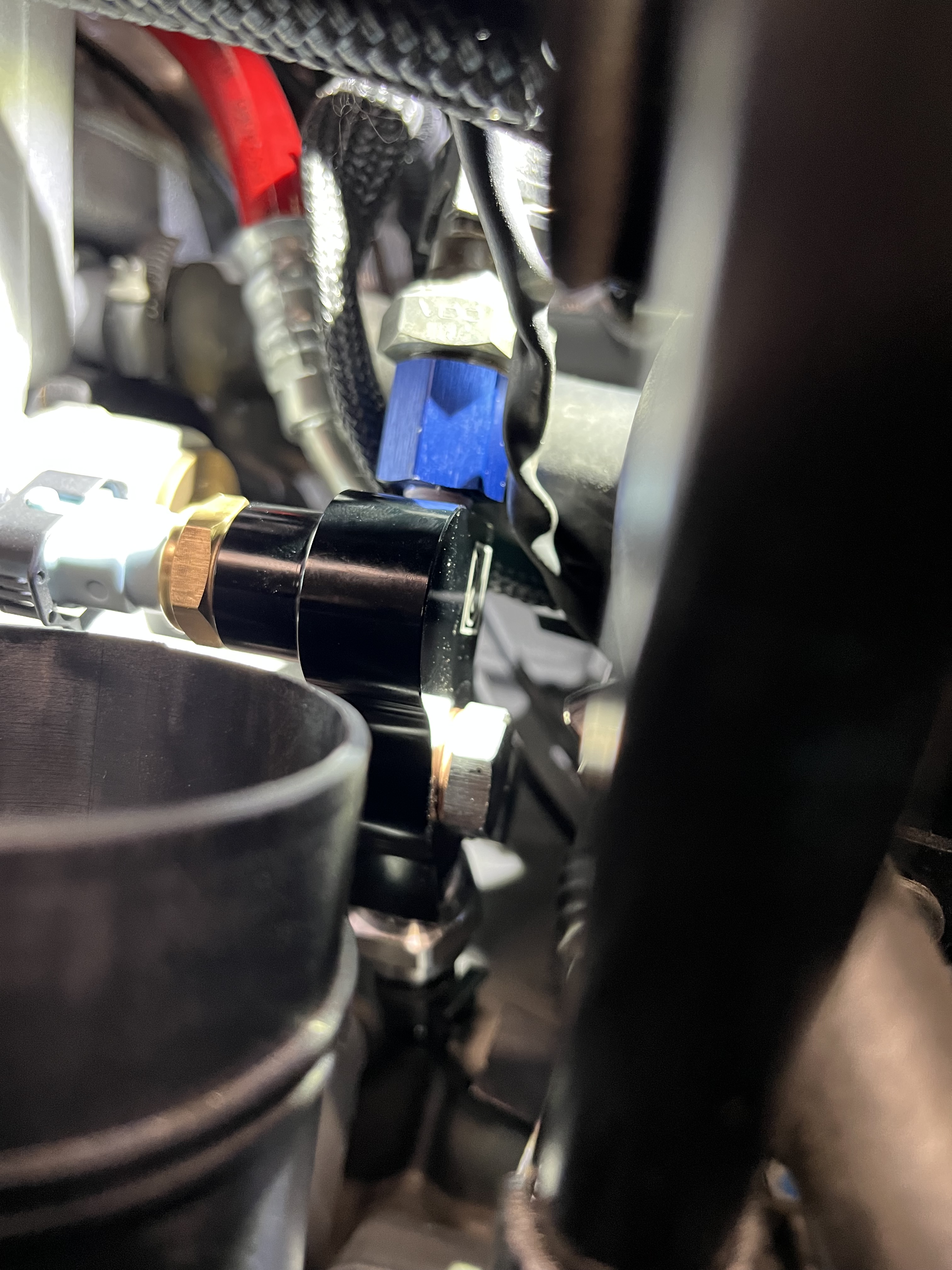

              Heres a few more as parts are arriving. Still waiting on chasebays catch can. Giving these quick disco connections a shot to see how they seal. Made by dyme PSI.

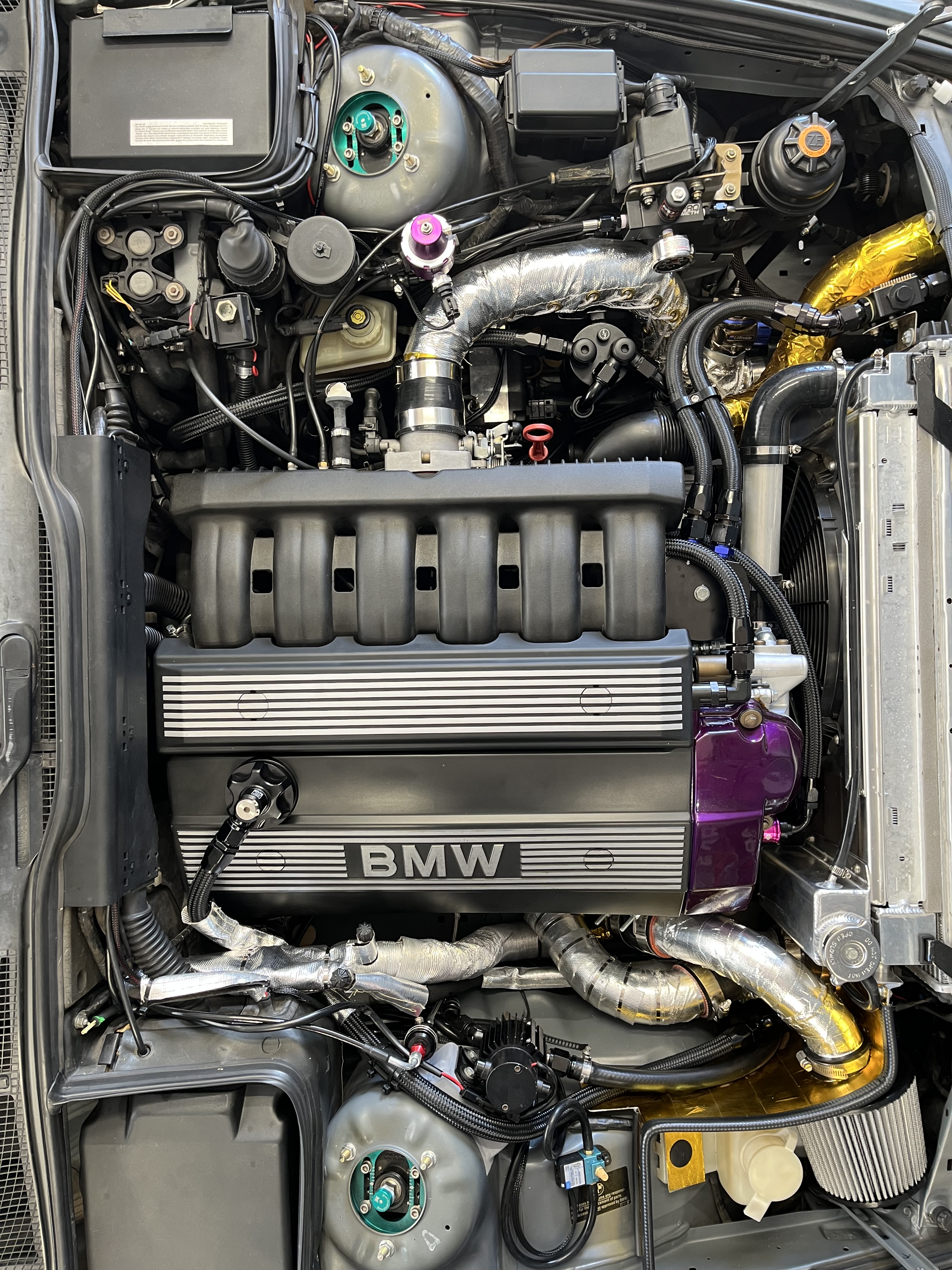

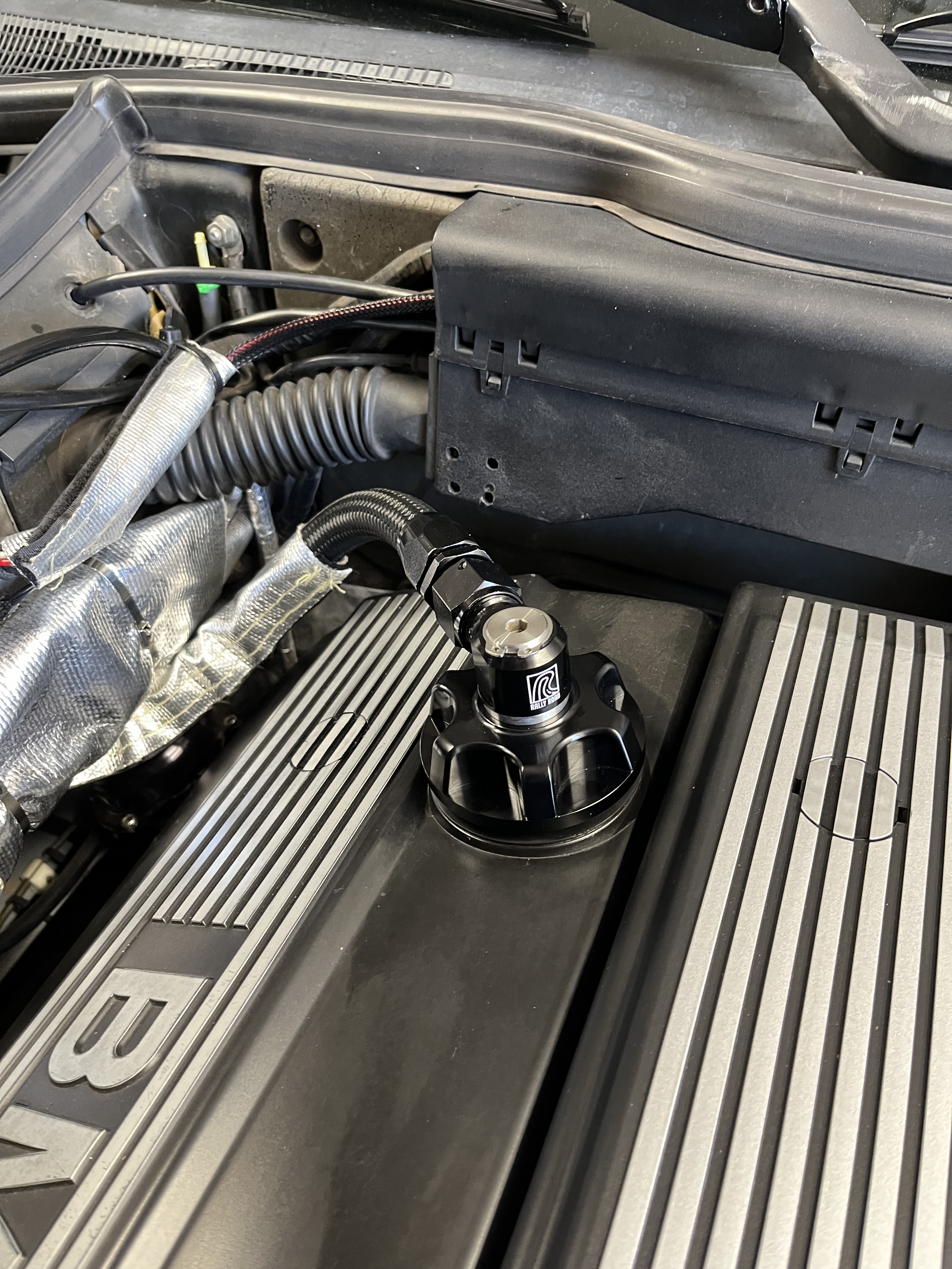

                Finished the crack case vent system.
                Final of the cluster
                And overhead pic of engine bay after work.

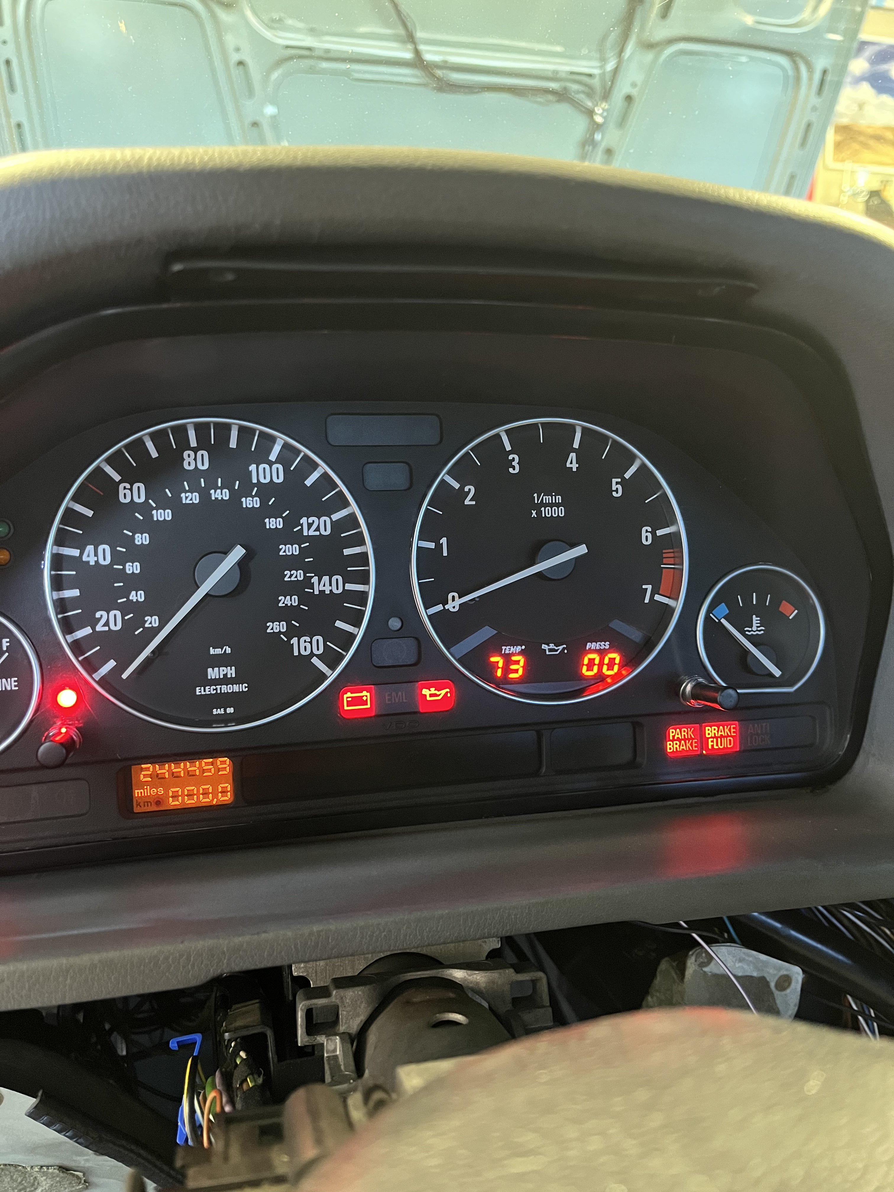

                  Rally Road oil block to house the temp and pressure sensors. Also retaining the dummy oil pressure light sensor for the cluster.
                  Also note:
                  If you want to do this pressure/ oil temp gauge you must cut off the pins that go to the actual econ meter needle mechanism and reinstall them into the cluster board to keep from getting a constant "check control" warning on the OBC.

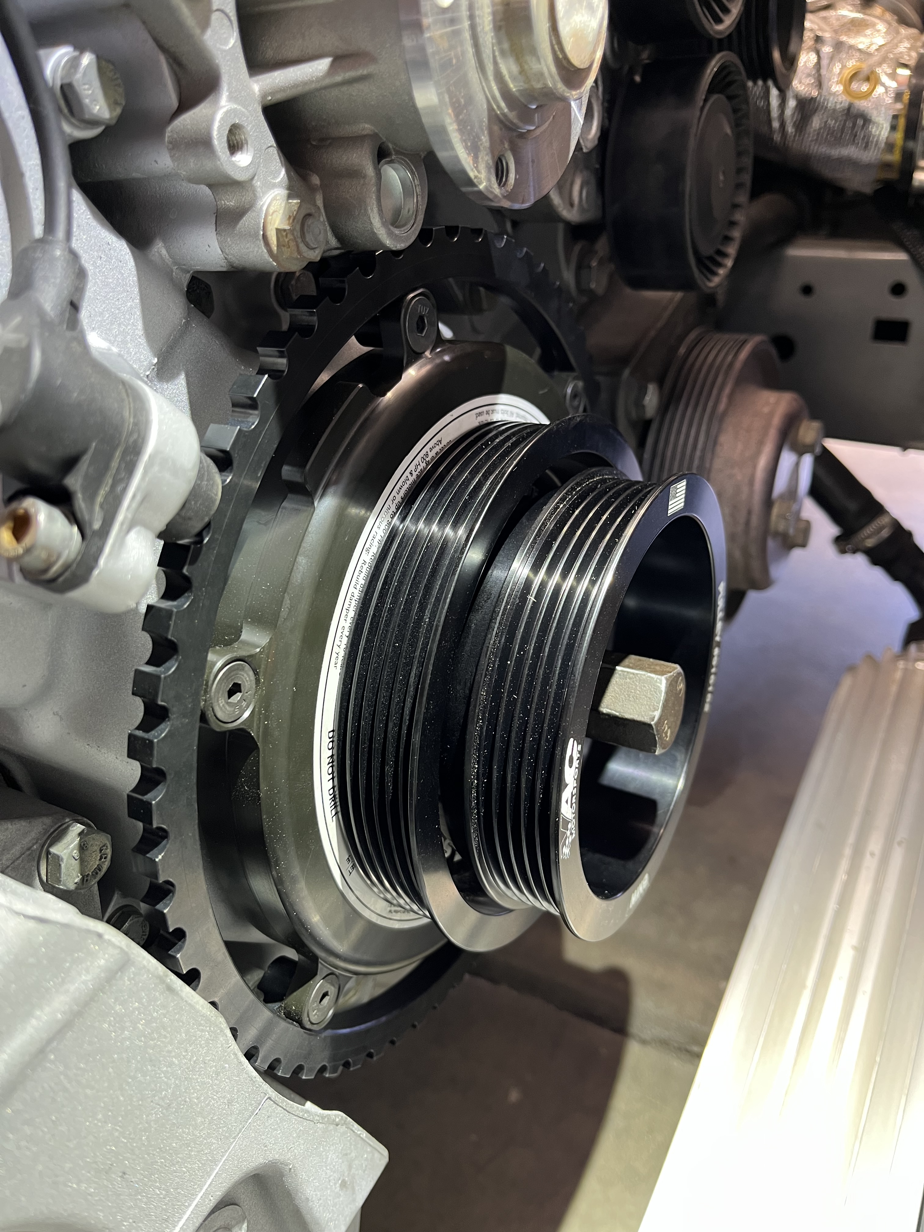

                          ATI Damper is installed. The unit is press fit and somewhat of a pain in the ass to install. 5lbs heavier than stock, should help out a bit with the loss of rotational mass at the flywheel. The chatter isnt terrible, but its there and noticeable.

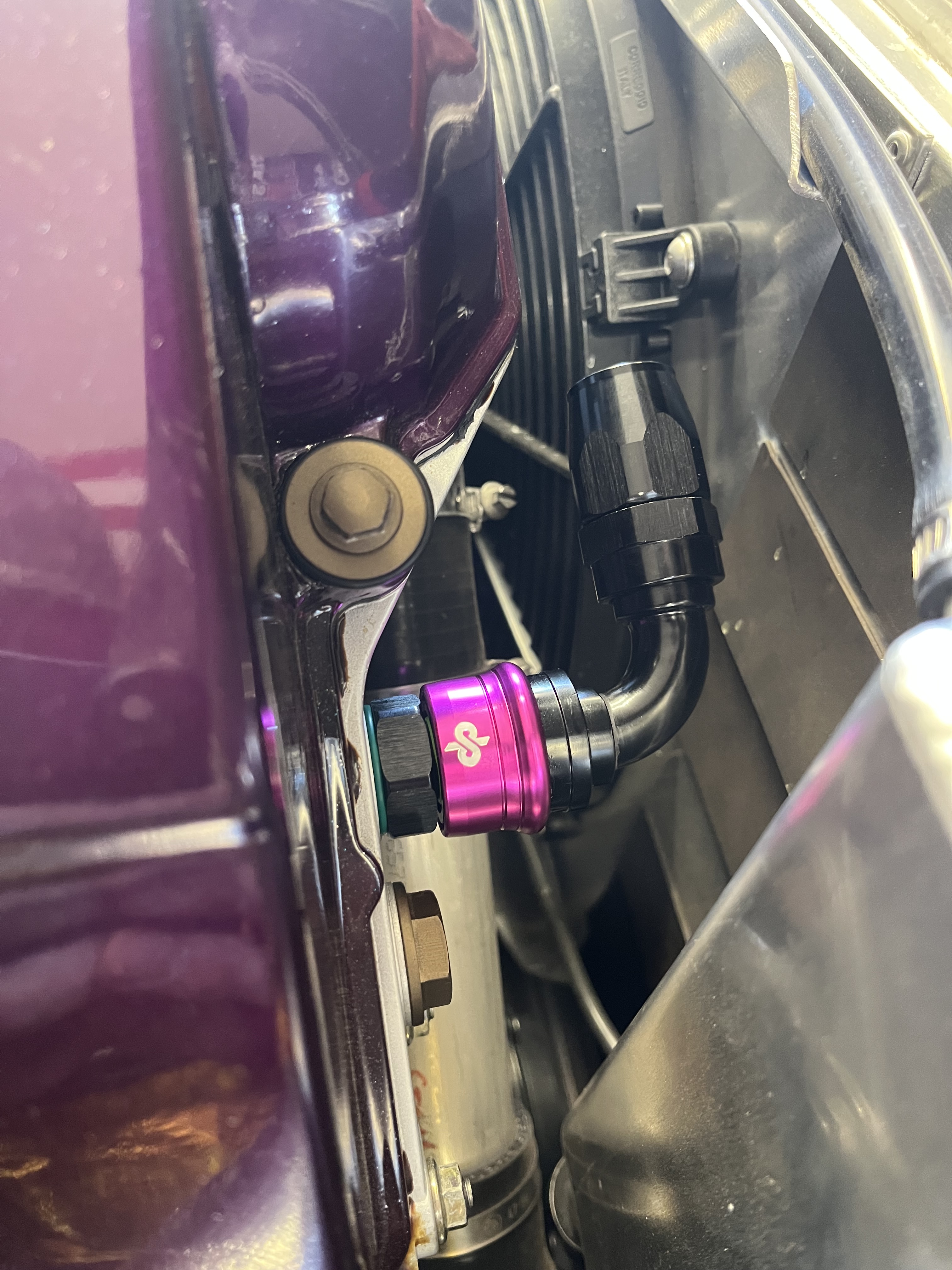

                              Finished the quick disco oil cooler connections this weekend

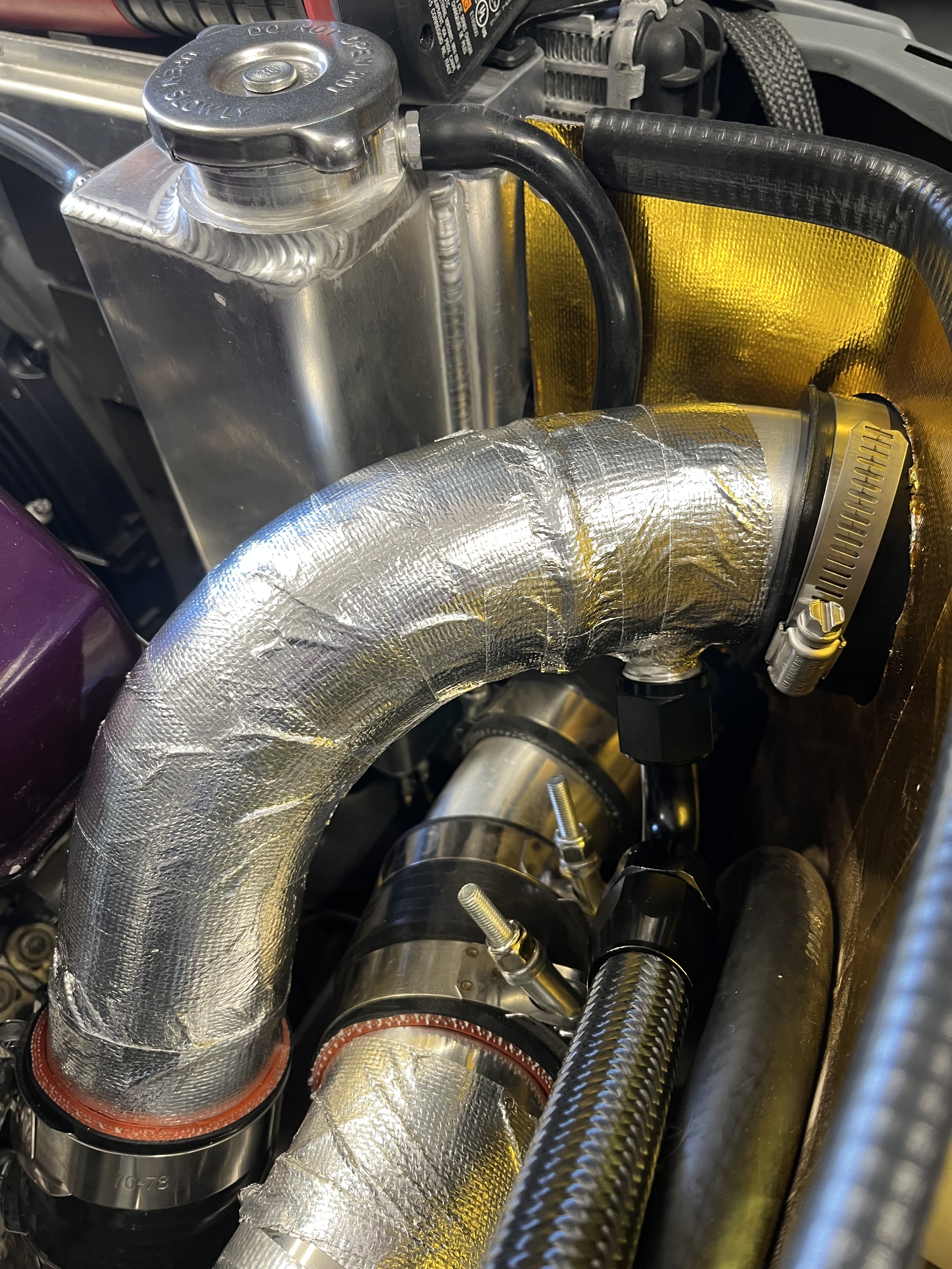

                                #615
                                Ran into a small problem with my vacuum signal going into the ECU box. I managed to pinch the hose somehow between the top cover and the bottom of the housing. Over a few days I noticed my engine started to act weird. Idle target way under. Seemed sluggish and all over the place. Idle injector on time was 3.2 ms. Thinking WTF I decided to smoke test the engine. Found my mistake in about a minute. The vacuum line was cut and leaking badly. Fixed it and its all back to crispy revs again. Good thing I didn't try and tune around this thinking it was a program issue!
                                At the beginning of next month I will be installing larger injectors and re-tuning the car. I have driven it about 1200 miles so far in its current state.
