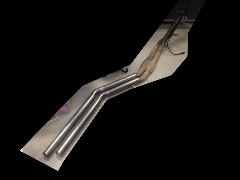

                          can you please post a pic of the new exhaust.
                          did they replace the stock exhaust manifold flange and down pipe flange area in the engine bay with v bands?
                          Project
                          Parts for Sale
                          Feedback
                          YouTube Channel
                          • Panici
                            • Dec 2009
                            • 2575
                            #163
                            They replaced the stock rear flanges with v-bands.
                            I will get some pictures for you when I am under the car next.
                            Meanwhile, imagine v-bands welded to the ends of these stainless pipes (at the bottom of the image), and then also to the muffler section (which is not in the picture).
