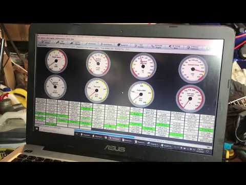

                    Motor Swap, Round 2!
                    I didn't trust the engine I pulled from that E39 way back on Page 1(?!) of this thread. It sat outside under a tarp for 6 months, and has moved houses multiple times.
                    So now it's a spare/parts engine!
                    I picked up a cheap E36 328ic, had a few friends over for a weekend, and pulled that sucker out!
                    Then I got to work prepping the engine for swapping into the E30.
                    • Welded the oil pump nut
                    • Installed the front sump pickup & pan.
                    • Installed EGR blockoff plates
                    • Mounted the motor to some wood blocks.
                    • Went through and sliced up the original harness, labelled everything appropriately.
                    • Modified the new dipstick for the front-sump pan.
                    • New rear main seal, new accessory belt.
                    • Made brackets to mount starter in place with transmission removed.
                    • AC Deleted
                    Now onto the wiring. Made my own harness to run a Megasquirt MS3X Standalone ECU. Running full sequential ignition and injection, knock sensor module. Standalone ECU is a big step towards my eventual Turbo plans!
                    It took some testing to find that I needed an M50 camshaft sensor using a 1K pullup resistor to +5v.
                    Also needed the DIYAutotune Hall Effect crankshaft sensor with pullup resistor to +12v. Key point here was that this needed to be mounted to the front (OBD1) crank sensor location. I could not get it to read correctly with the rear sensor location in the block.
                    Hooked up the E36 exhaust (sans muffler), and cooling system. Made a timing light adapter for the COP system, and set the timing.
                    Ran it up to full temperature with great success! (see video below)
