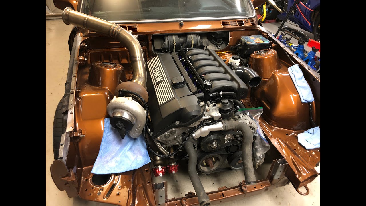

                          Engine Test Fire!
                          Worked hard again this weekend on the car. I estimate 13 hours of solid wrench time over two days.
                          Made up a -4AN turbo oil feed line using JEGS Pro-Flo 350 Black Nylon Braided Hose. It’s rated for 300F
                          so I'll be using some heat wrap near the turbo. Wanted a Nylon line as I'm routing it tight to the head
                          and SS line can rub through adjacent components.
                          Used a 120deg fitting on the turbo side to route the line a little nicer.
                          Reused the existing turbo drain from the parts kit but had to cut and refinish the stripped end of the
                          fitting for the drain-to-timing cover.
                          Installed a MaximumPSI M50 Boost-proof ICV hose kit with Billet ICV barbed fitting and 3” silicone
                          elbow. Added two 1/8” NPT nipples to the bottom of the manifold as a vacuum/boost source.
                          Installed the clutch master to res line.
                          Installed the M50 intake manifold with new gaskets on the runners and throttle body (with adapter
                          plate). Happy that my brake booster still clears the intake as I shimmed the passenger side motor mount
                          up and moved the booster back (since the previous engine install.)
                          Deleted the intake oil separator. Installed a RallyRoad Billet fuel rail, Injector Dynamics ID1050x
                          injectors, 034Motorsport injector adapters, JEGS fuel pressure gauge.
                          The AN barb fittings I bought for the rail are the wrong size (too big). I made it work to test fire but have
                          ordered a few more (expensive) AN bits to make the setup cleaner.
                          Wrapped the motor mount and arm in heat wrap, and applied DEI Reflect-A-Gold to the frame rail
                          where it is very close to the exhaust manifold.
                          Changed the oil with some fresh Shell Rotella T6 15w40 and MANN filter. Found out my front fuel line is
                          right over top of the filter housing and in the way of servicing the filter.
                          Installed the dual TIAL MV-S wastegates with green 4lb springs.
                          The First Startup:
                          I pulled the Fuel Pump relay and turned the key intending to prime the engine with oil. Instead of the
                          engine turning over, I was greeted with a whirring from the starter and nothing else. Sounded like the
                          bendix was not extending/engaging with the flywheel. This was a little baffling as this is the exact same
                          starter and flywheel as I previously ran, (and I didn’t even unbolt the flywheel when I changed the clutch
                          and trans). After a shower and sanity check post on R3V facebook, I went back to my pictures of the
                          previous engine assembly in 2020 and found the small Blk/Yel starter wire should be on the bottom
                          terminal, not the top. Thanks to my efforts of optimizing everything under the intake manifold, I was
                          able to change the wire position on the starter without pulling the intake off again.
                          After building oil pressure on the starter, I installed the fuel pump relay and the new Aeromotive 340
                          fuel pump came to life. Cycled the key while watching the fuel pressure gauge, and could hear when
                          everything was primed and ready to go.
                          Made a quick adjustment from the previous tune by changing the Req Fuel in the MS3X for the new
                          1065cc injectors.
                          Turned the key one final time, and the engine roared to life! Ran it for less than a minute doing a quick
                          walkaround (as the cooling and power steering systems are both dry).
                          Needless to say, I was very happy to hear the E30 run after so much time! Last time it spun under it’s
                          own power was October of 2020.
                          This was my first foray into engine internals, and it was a relief to see 50lbs of oil pressure and no
                          strange noises or leaks.
                          There is still plenty left to do before the car is ready to hit the road, but this is a big motivator to keep
                          pushing forward.
                          https://www.youtube.com/watch?v=k-o9x1n8zdA

                                Interesting decision of where to put the oil return.
