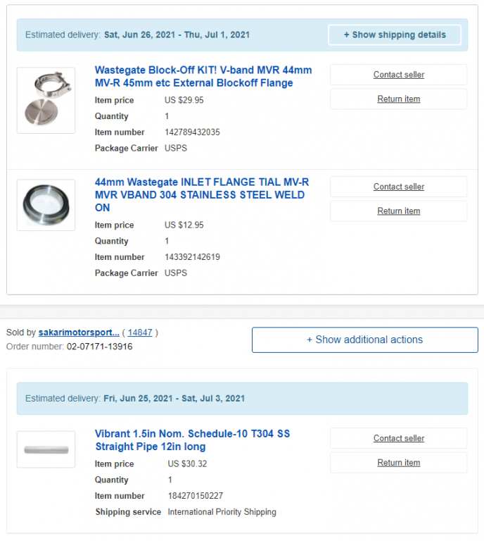

          I talked to pazi88 and Armen Hovh who have done low boost cars on 44mm or smaller gates, so I decided to forgo the $800 wastegate upgrade and attempt to dodge the fitment issues.
          I still need to choose a flex section between the WG and downpipe, just need to measure the exhaust tubing I have first.
          Hopefully this is all I need to mount the WG to the turbine housing and recirc into the exhaust. I'll miss the screamer pipe, but oh well.
