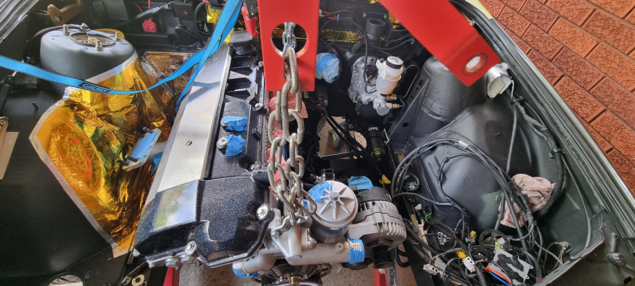

                  #1958
                  Originally posted by moatilliatta
                  Hey, I am going to recommend the high volume vac S54 oil pump.
                  Save you some time, and noisy lifters..
                  And for good lord, use the AKG swap mounts with Rouge trans mounts. Those Delrin rigs with buzz bomb the car apart. :)
                  I seem to be having fitment issues. Angles don't really line up. I followed AKG instructions. Set everything up loose. Still sits wonky.
                  Sent from my SM-S931U using Tapatalk
                  '89 325i OBD2 S52 BUILD THREAD
                  Shadetree30
                  • amcp
                    • 489
                    #1959
                    Trans mounts are loose too?
                    The AKG mount isn't sitting flush on the crossmember. I had mine sitting flush then the arms wobbled in. I used a 2x4 under the oil pan to assist, made it a bit easier.

                        #1961
                        Interesting. Both my previous revshift mounts, and the condor mounts, both had offset bolt positions side to side, vs these AKG mounts are symmetrical. I seem to be fighting this difference. Though I did manage to get them sitting more flat with much wiggling when settling. Still doesn't seem right. Gonna leave it for now cause I planned to drive it this weekend. Will revisit and reach out to AKG.

                              #1964
                              I had this issue as well with my AKG's. L/R were identical iirc so it didn't matter if i swapped them around or flipped them at all - it's been a LONG time since i addressed this though. I ended up throwing some washers under it to raise the motor for header clearance and it sat pretty flat, but I was never happy with that. I have some solid aluminum AKG's for 24v to go in next time, but have been 2nd guessing going solid mounts for quite some time now. I think custom motor mount arms might be the solution I need to use these properly - or just buy the revshifts. Last time I checked the motor mounts have been taking all the abuse I've thrown at it over the years drifting, but its still not an excuse for fresh production mounts to have this issue 10 years later..I'll check back to see what they say to you
                              89 325i 4dr s52
                              02 BMW 525iT m54b30/manual swapped (daily) *sold in 2020 repurchased in 2025*
                              21' Toyota Tacoma TRD OR 4x4 6 speed Manual
                              • almostacrayon
                                • Nov 2012
                                • 157
                                #1965
                                There is a trick to doing it. Are you using a load leveler?
                                Since there is so much weight on the driver side (rhd car) you need to use a strap or something to pull up the engine to get it to line up on the pas side. I do this with the driver side arm off.
                                Once the pas side is all in i snug the nuts up and then work on getting the engine mount and arm in and aligned then slowly lower it via the engine crane.
                                Since all the weight is on the driver side it is easier for it to fall into place
                                Not sure if that makes sense or not?
