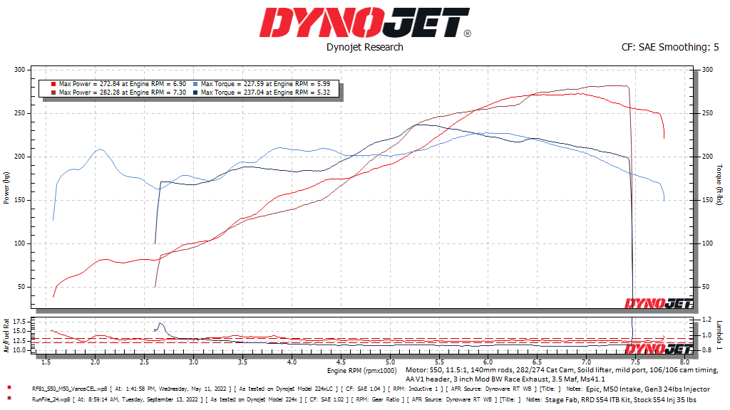

              A follow up from Sept 2022.
              I finally have a comparison of the dyno charts back to back of M50 intake vs S54 Intake, Notes on sheet.
              And.. I'm not sure if id consider it apples to apples as the same tuner didn't do both. You can see what they both tune the AFR's to. I assume there is more on the Stage Fab tune, and not sure why the Redline isn't higher as we originally spoke. .
              Randy at Epic didn't want to fool with the tune on the ITB setup because you had to change the range of the TPS at idle.. and also at WOT. Safe is better than grenade'd I suppose. Just more motivated for the offseason mods. :)

                #292
                Timing should remain close to the same since your long block is still there.
                AFR's don't change delta as much as people think in NA. Appears to me that the second tuner might not be familiar with BMW, but they really don't need 12.5:1 target at WOT. I find they are happier around 13-13.5.
                Some funky curves there, both of them. The first pull with the red line shouldn't have that dip from 4700-5200, that arc should carry across the graph. Just looking at the dyno sheet, doesn't appear to be a fuel issue. Then the ITB graph has that same weird dip.
                I suggest you maybe play with cam timing, or even eliminate the VANOS in a race car.
                Here's what my 24v graphs usually look (before and after dyno session) LINK

                  #293
                  The Epic tune was locked, so the next tuner had to start from scratch.
                  Agree closer to 13 would be good. Not many places my way do ms41 tuning around here..
                  I haven’t looked into the tune, with peak TQ so late maybe the Vanos is switching at 6300.

                    #294
                    gainz from 4600-5900 are noice. Wonder if it'll be balance out what was lost from 3700-4600.
                    Looks like it would've continued make power to 8k if revved that high.

                      #295
                      Based on your NA peak power, I would gather you will be closer to 300whp when you get everything sorted. Quality ITB's have shown me 30-ish WHP on almost every build.
                      Reach out to MarkD. He will tune your car over the internet.

                        #296
                        So looking though the run files, it looks the actual last sent run file doesn't have the dip at 6300.
                        Hopefully this spring well find out if it makes power to 8K.

                          #297
                          Alive after five.
                          I've had Mark-D do some chips. Great guy to work with. Does he fool with MS41?
                          Dip isn't 6300, your anomalies are around 4300.
                          It will live to 8500, but your harmonic damper won't survive, and I hope you have the Euro (or NV US) oil pump chain tensioner, or that system will vibrate to death.
                          Yes, Mark is a great tuner, worth reaching out. Last time we chatted, he was doing much later DME's than millennium baby 6's.
                          I wold help you, but I barely get by flashing Siemens for my own jobbers, not to the point I feel convertible emailing .bin files.
