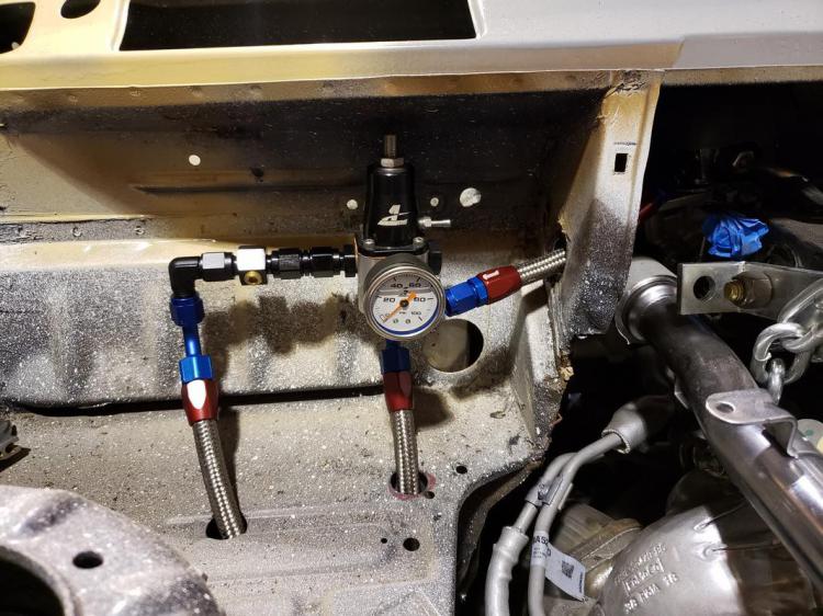

          made all the fuel lines tonight. I love working with braided stainless lines and an fittings
          return and vent line
          feed line and return line going through the floorboard
          fuel pressure regulator setup
          • 2mAn
            SeƱior Mod
            • 20954
            #110
            You'll want to make sure to have grommets around those lines where they pass through the body. not joking around

            • Sh3rpak!ng
              • Jan 2014
              • 2667
              #111

                #112
                yeah hopefully those holes are 1" not +1" because harbor freight sells a grommet kit with 1 inchers thatd be convenient.
                I was looking at my fuel pump and I just realized how crazy loud the pumps gonna be in the cabin like that lol oh well.
                in other news I confirmed that the hood is going to fit with no mods so that's nice.

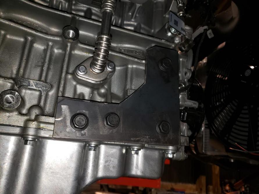

                          #117
                          I got around to the motor mounts because I finally got my subframe fastener delivery
                          heres my mounting plate for the engine block
                          tacking it up I gotta be careful because I don't use an auto darkening welding hood.
                          now for the fun part
                          • hkv
                            • Jul 2019
                            • 274
                            #118
                            heres the finished product
                            Click image for larger version  Name:	20190922-013408.jpg Views:	0 Size:	59.7 KB ID:	9871904
                            Click image for larger version  Name:	20190922-015804.jpg Views:	0 Size:	71.3 KB ID:	9871905
                            Click image for larger version  Name:	20190922-015925.jpg Views:	0 Size:	83.6 KB ID:	9871906
                            • hkv
                              • Jul 2019
                              • 274
                              #119
                              passenger side was nice and easy, I have the plate made for the drivers side but that mount will be more challenging because the steering and alternator are in that area and the mounting area is even farther back than the passengers side.
