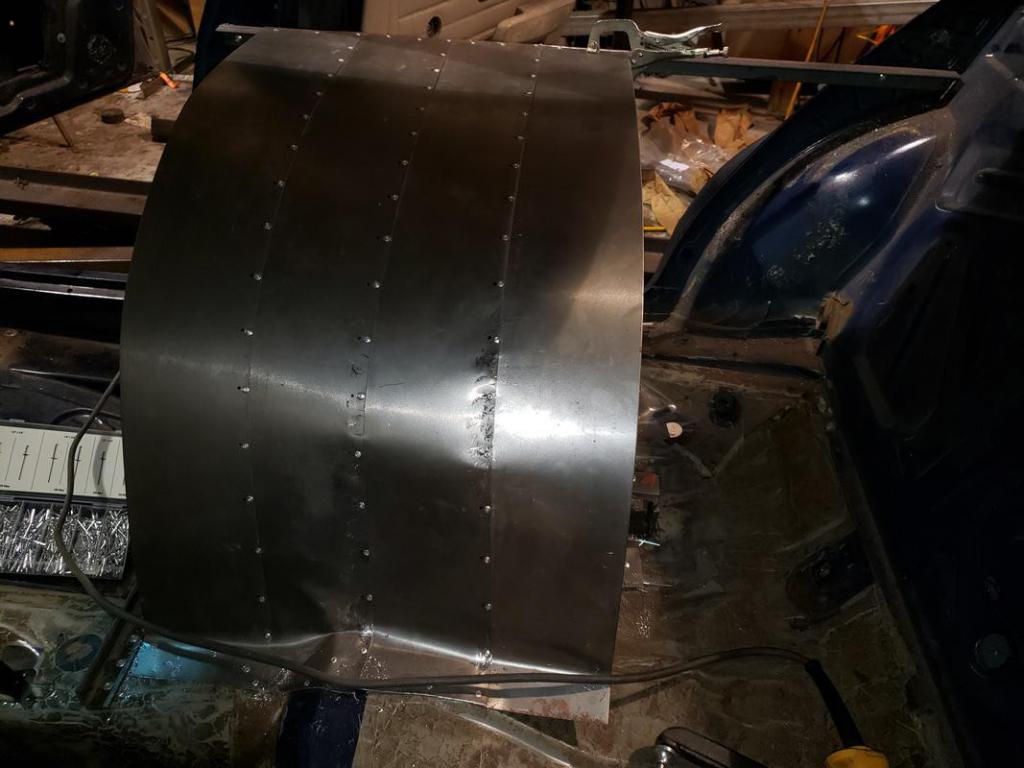

                #97
                so originally I was planning to have a firewall tightly wrapped around the fuel cell because I want some protection from it in the cabin but then I had a eureka moment because doing that I would have had to leave the filler cap open to the cabin. what I decided to do is make a little compartment that completely seperates the fuel cell from the cabin but still allows me to fill it up by opening the passenger side rear door.
                so you can see how it works. door closed ill have it sealed off from the cabin. door open and I can fit a gas nozzle in there and fill her up. no problem

                      #100
                      getting close on the tanks firewall. now I just have the front section to deal with
                      Click image for larger version  Name:	20190919-013044.jpg Views:	0 Size:	78.3 KB ID:	9871315
                      Click image for larger version  Name:	20190919-012824.jpg Views:	0 Size:	80.7 KB ID:	9871316
                      Click image for larger version  Name:	20190919-013212.jpg Views:	0 Size:	80.7 KB ID:	9871317
